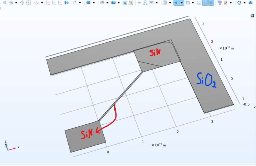

I followed your suggestions and tried a much finer mesh and I also extended the overlapping surface so that there are more than just 1 mesh domain in the overlap region (as showed in the picture). Unfortunately, this changes didn't give any improvements ( eigenfrequency of fundamental mode and Q change at each run).
Do you think that using an Union instead of an Assembly (as I am doing now) could give improvements? I am open to other suggestions. Thank you
>Réne is correct about the assumption of ill-conditioning. You can improve things by using a better mesh. Avoid those highly distorted elements, and use a finer mesh in general. > >But there is one fundamental problem. You use a continuity condition between two partially overlapping boundaries. With the current mesh only small fractions of elements overlap in that region. That makes the connection completely unpredictable. I would guess that it acts as a hinge, and that may not be the intent. You need to have at least one full element on the destination side overlapping the source side in order to transfer a moment. I followed your suggestions and tried a much finer mesh and I also extended the overlapping surface so that there are more than just 1 mesh domain in the overlap region (as showed in the picture). Unfortunately, this changes didn't give any improvements ( eigenfrequency of fundamental mode and Q change at each run). Do you think that using an Union instead of an Assembly (as I am doing now) could give improvements? I am open to other suggestions. Thank you
