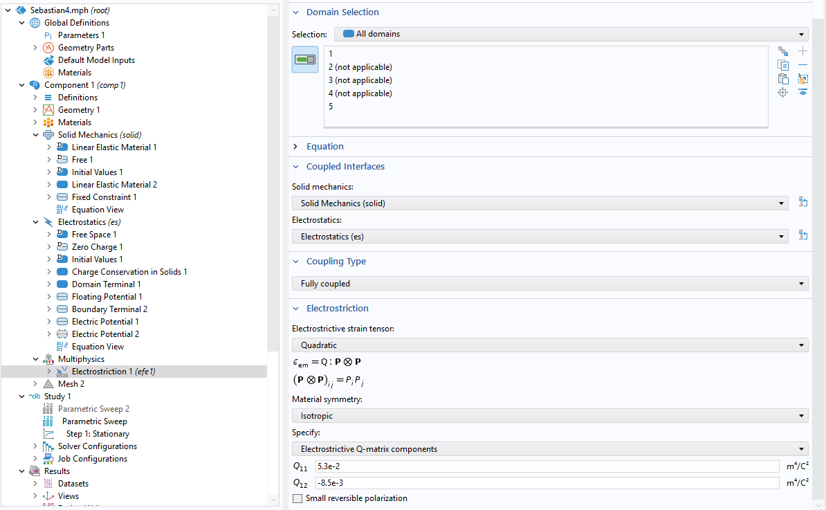

I have another question regarding the electrostriction effect: how can I add this effect? I used the coupling for electrostriction and added the Q electrostriction tensor, is this enough? It seems to me that I am missing something.
I am sending a printscreen of the physics I am aplying to my model, as the geometry of my problem too.

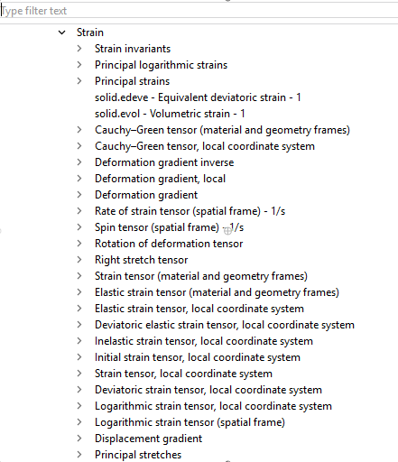

I am not certain that I fully understand your question. There are many types of strain results available in the result menus, including strain components in local directions, and the principal strains. See the attached screenshot.
