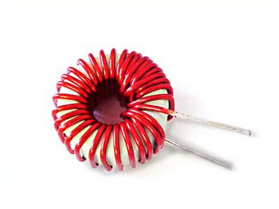

I want to determine the inductance of a toroid core + winding as shown in .jpg
I specify an external current density, such that the current flows around the core (in r and z direction).
