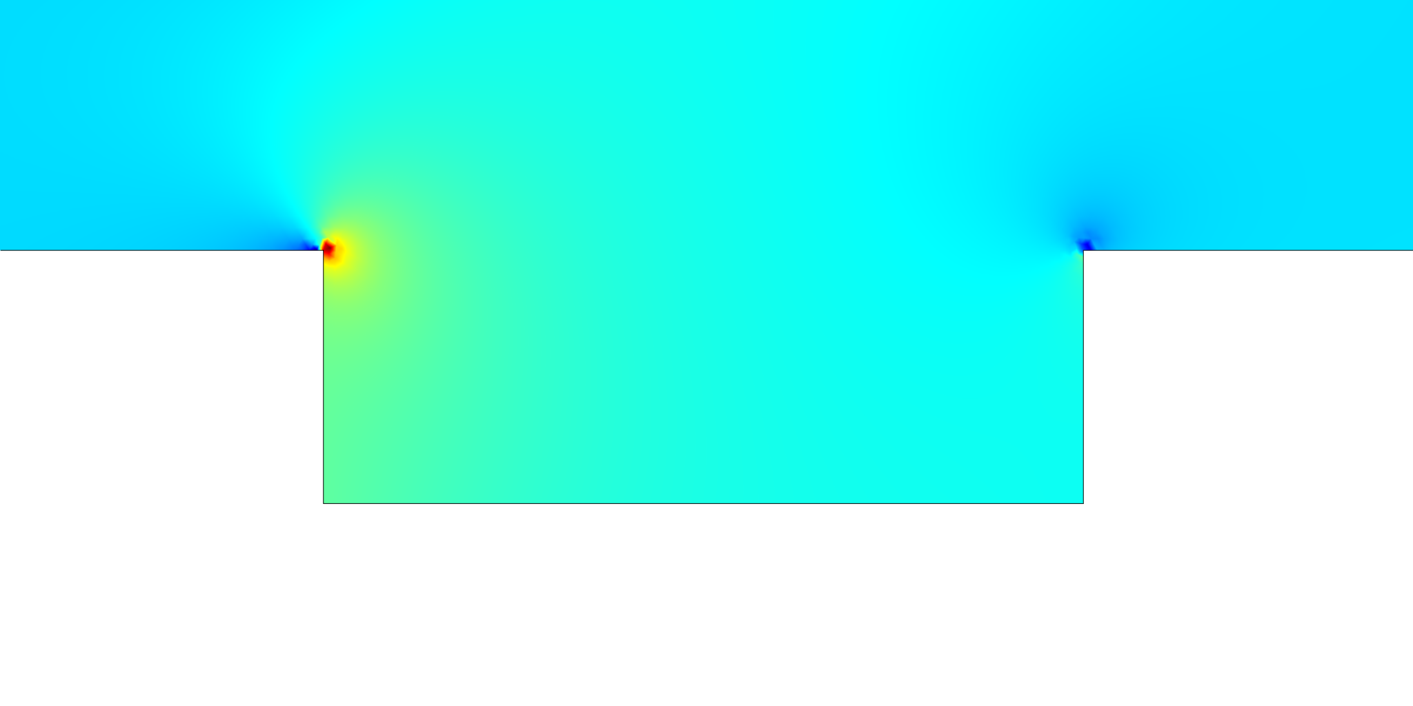

Unfortunately I cannot attatch the file, but I have added a picture of the electrical current resulting from the potential difference between the two vertical walls. Red is a highly positive current and blue is a strongly negative current.
The two vertical walls have a defined electrical potential, whyle the other walls are electrically insulating.
As you can see the electrical current shows high currents at the sharp edges at which the wall with a defined potential meets an insulating wall.
I expect at these walls a smooth transition in the current. I have no reason the expect the current to rise strongly.

these are indeed singular points in your model. You set a constraint on the potential which cannot be kept, this will result in very high currents near the corners. As your mesh gets finer, the current gets larger but over a smaller area. The total current will get constant.
I attached an example of what you can do to modify the model so that these singular points are removed. I set the boundary slightly outward from the wall, and inserted fillets to round off the corners (other typical singular points).
Another option is to ignore these singularities. Just use a (much) finer mesh, and you'll notice that the potential distribution is correct. You'll see that several mesh elements away from your singularity the current is as "expected".
If you are interested in the current flowing from your boundary condition, you can enable the weak constraint so that you can evaluate the lagrange multiplier, this gives you more accurate results.
