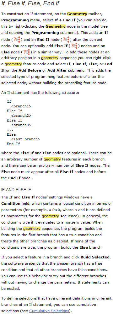

Thank you for your quick response! Perhaps this is what you are trying to show me with the domino.mph file, but I am trying to define a geometry based on a conditional statement as explained in the help documentation which is shown in the attached image. If that's what you gave me sorry for not understanding it better (I'm quite new to COMSOL still). What would be awesome is a tutorial of sorts to understand how to use the feature. Again, thank you for your help!

I am opening this subject again as I need to ask how to assign materials for the different geometry parts under the statements.
I have a difficulty assigning properly the materials as COMSOL only allows me to assign a material to the first if statement. Then the geometries under the rest 'else if' statements are assigned a material based on the first if automatically but not always in a right way. I need to be able to assign a material to each one of them myself but I can't find a way so far...I had some advices form COMSOL support team but it didn't seem to work.Any help would be much appreciated!
