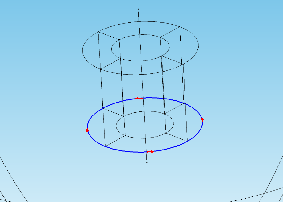

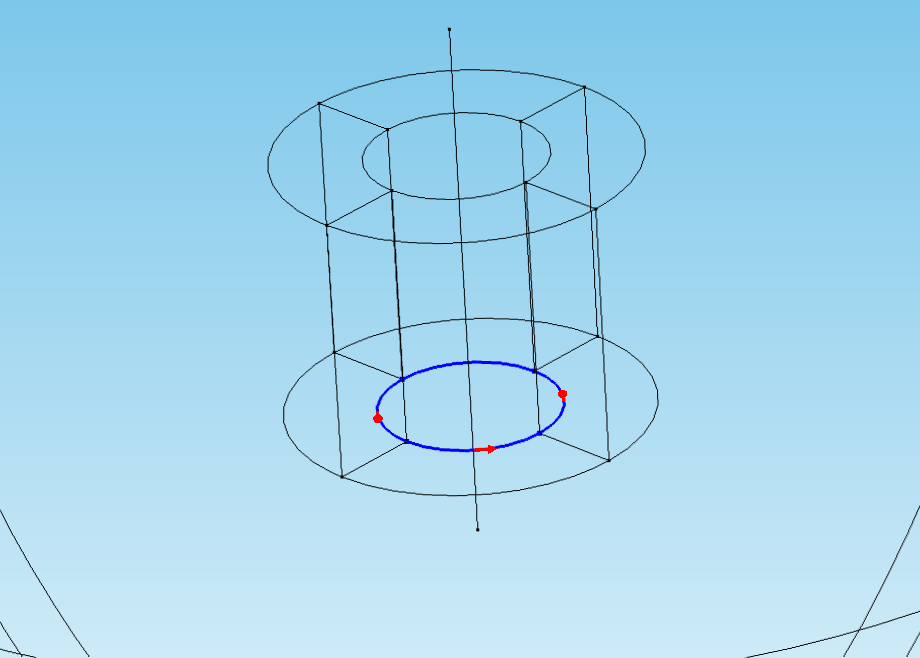

I am right now researching the air-core inductance for two concentric coils. I tried to energize the outter coil with current and globally integrate the magnetic energy, then divide the energy with current we get the air-core inductance. Problem occurs on the current load. It is told there are three default coil types, say linear,circular and numerical. In this case I choose the circular coil type, and needs a reference edge to define the path of current. The modle has two edges, say inner and outter, both of them offer same current value and distribution, but the final inductances have nearly 20% difference. I attach the figures below to make it clear.
So, I want to know which edge should I choose to make the simulation more reliable.

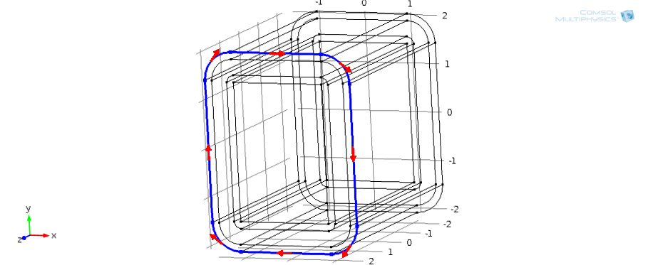

Both choices are incorrect since your coil is not circular. You need to use Numeric coil type and add additional Coil Current Calculation study step.
Sergei
Qiong, Both choices are incorrect since your coil is not circular. You need to use Numeric coil type and add additional Coil Current Calculation study step. Regards, Sergei

The edge chosen will be used as a "mean diameter" for your coil for the purpose of calculating the coil resistance, so you will get different answers depending on which edge you choose. You should construct your coil so that there is an edge at the midway diameter between inner and outer.
Mark
The edge chosen will be used as a "mean diameter" for your coil for the purpose of calculating the coil resistance, so you will get different answers depending on which edge you choose. You should construct your coil so that there is an edge at the midway diameter between inner and outer. Mark
