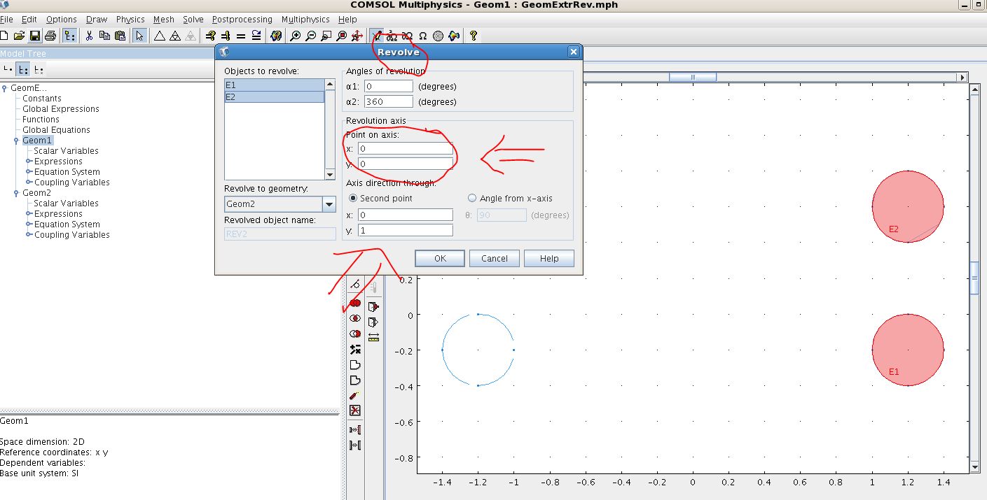

You have the 2D draw "extrude" and "revolve", for which you can "twist" and define an external rotation axis respectively, a simple illustration is given below. Start from a 2D and itwill create your 3D Geom at will
Have fun Comsoling
Hi You have the 2D draw "extrude" and "revolve", for which you can "twist" and define an external rotation axis respectively, a simple illustration is given below. Start from a 2D and itwill create your 3D Geom at will Have fun Comsoling Ivar

Dear Ivan,
thank you for your response. I can't find where/hoqw to define an external axis for the revolution of extrusion.
Thank you.
Franz
Dear Ivan, thank you for your response. I can't find where/hoqw to define an external axis for the revolution of extrusion. Thank you. Franz
Posted: 2 decades ago 2010年4月28日 GMT+2 10:41
you should see something like this, no ?
Hi you should see something like this, no ? Ivar

ahhh, now I understand what you mean by "external" axis. Of course, that is a possibility of doing this. Sorry, I just did not think about it that way. I was looking for something like the extrude along path thing. Ok, I see I can solve this particular problem like this, thankl you very much for pointing my head in the right direction; but what would I do if I need a more complex path? I mean do I have to basically split it into several tiny pieces and cunstruct it in this manner?
