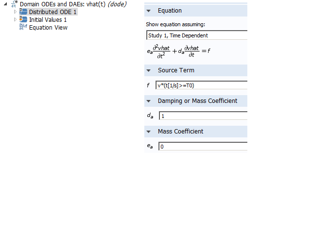

Peter,
You can use Domain ODE and DAEs (dode) interface to perform this integration, as shown in the attached image.
Sergei
Peter, You can use Domain ODE and DAEs (dode) interface to perform this integration, as shown in the attached image. Regards, Sergei

Thank you for the comment Sergei, however as I understand it, your suggestion would make vhat define by
vhat(t) = integral of v(t) from T0 to t, (Sergei's suggestion)
and not
vhat(t) = integral of v(t) from t-T0 to t, (what I wish to achieve)
as I would like it to be.
If I am wrong please explain it to me.
The question is still open for suggestions.
Thank you for the comment Sergei, however as I understand it, your suggestion would make vhat define by vhat(t) = integral of v(t) from T0 to t, (Sergei's suggestion) and not vhat(t) = integral of v(t) from t-T0 to t, (what I wish to achieve) as I would like it to be. If I am wrong please explain it to me. The question is still open for suggestions.

Peter,
To calculate integral of v(t) from t-T0 to t, you can define two functions using Domain ODE and DAEs:
vhat1(t)= integral of v(t) from 0 to t, with Source Term f=v
and
vhat2(t)= integral of v(t) from 0 to t-T0, with Source Term f=v*(t<=T0)
Then final result is
vhat(t)= vhat1(t)-vhat2(t)
Sergei

Peter,
Actually, final result should be
vhat(t)= ( vhat1(t)-vhat2(t) )*(t>=T0)
Sergei
Peter, Actually, final result should be vhat(t)= ( vhat1(t)-vhat2(t) )*(t>=T0) Regards, Sergei

Thanks again for your effort to help me Sergei. I think your idea is good, I agree on the method of vhat(t)= ( vhat1(t)-vhat2(t) )*(t>=T0), and it brought me one step closer to what I want, however, the differential equation
partial_t vhat2(t) = v*(t<=T0), which you proposed, will as I see it define vhat2(t) as
vhat2(t) = time integral of v(t) from 0 to t, for t<=T0 and
vhat2(t) = time integral of v(t) from 0 to T0, for t>T0,
and thus not as we desired
vhat2(t) = time integral of v(t) from 0 to t-T0.
I am not sure how to do this integral.
Once again thank you for contributing Sergei, I welcome any further ideas you have.
Thanks again for your effort to help me Sergei. I think your idea is good, I agree on the method of vhat(t)= ( vhat1(t)-vhat2(t) )*(t>=T0), and it brought me one step closer to what I want, however, the differential equation partial_t vhat2(t) = v*(t
