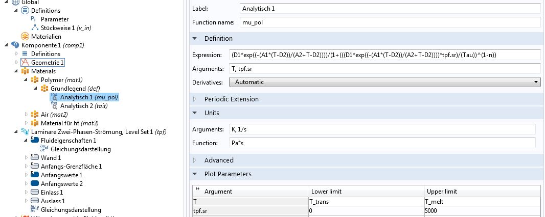

i defined my own analytic function in the "Materials" sub-categories. My function (its the Cross-Wlf-model) depends on the shearrate and temperature.
You can use the automatic calculated shearrate as the function argument.
In my case its called "tpf.sr". Tpf for the two-phase-flow and sr for shearrate. You have to look how your shearrate variable is named.

Hi, i defined my own analytic function in the "Materials" sub-categories. My function (its the Cross-Wlf-model) depends on the shearrate and temperature. You can use the automatic calculated shearrate as the function argument. In my case its called "tpf.sr". Tpf for the two-phase-flow and sr for shearrate. You have to look how your shearrate variable is named. Greets Ingo
