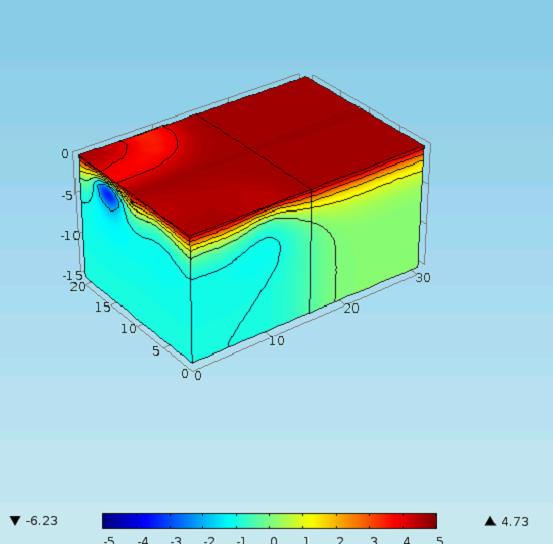

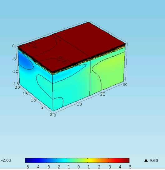

Sergei, thank you alot for your answer!
All right, model to solve good, but... but i have non stable solutions for first years... I attach picture. With unstable and stable solution respectively...
Tompson
Sergei, thank you alot for your answer! All right, model to solve good, but... but i have non stable solutions for first years... I attach picture. With unstable and stable solution respectively... Best regards, Tompson
