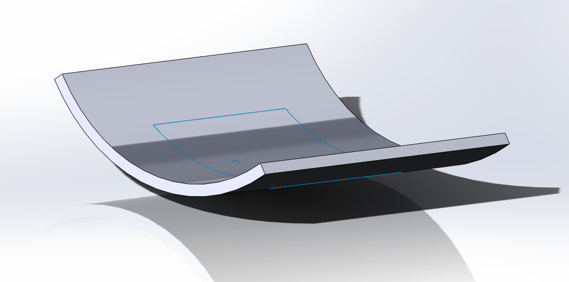

Concave Workplane / Concave Geometry
Do you know if there is a way in order to draw attached geometries in COMSOL?
Or any idea if I am able to create a concave workplane?
Thanks in advance.

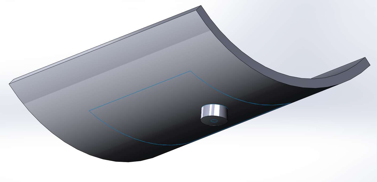

Thank you very much for your help. Actually I have already tried what you mentioned however I have stuck when I was trying to draw mounted concentric cylinders which are mounted on the concave surface. Do you have any idea if I can draw those cylinders too?

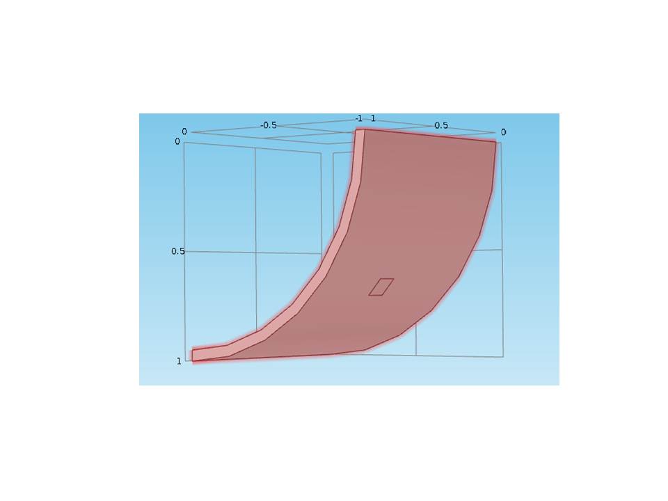

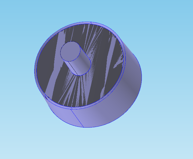

Thank you very much for your advise. I have already tried to Import my CAD file as well. However I have got some geometry issues. So my simulation didn't work properly. I think the attachment explains my problem much better.
Do you have any suggestion for this problem?
Thank you.
