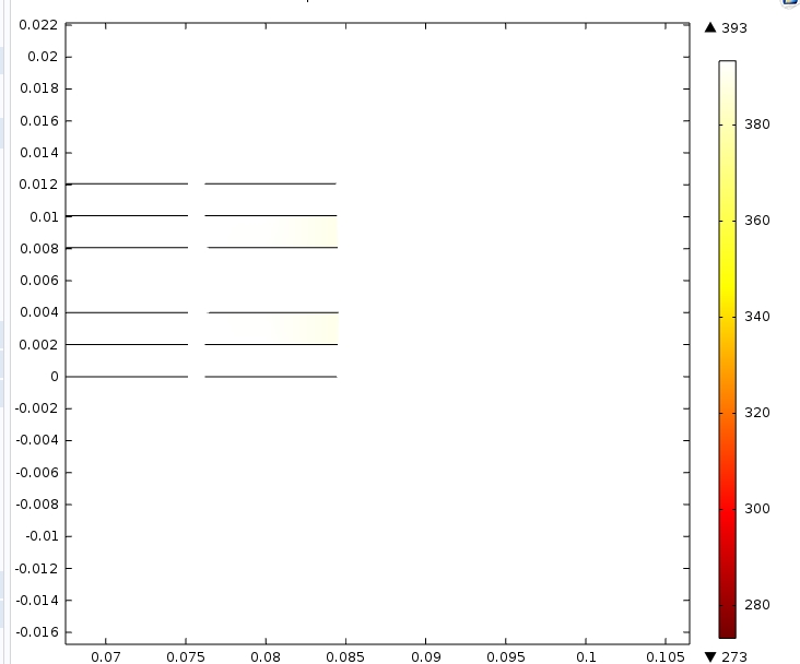

Hi I am trying to simulate a heat transfer problem in comsol 5.0 academic kit license. I want to change the color of the legend to vibgyor spectrum. how can I do it?

The data/colortables/ directory of the installation contains the color tables that are available. If you place a file in the same format in that directory and restart the program, then the new color table will be available. You can also place the file in the preferences directory (e.g., $USER/.comsol/v51). The file format is described in the documentation - search for "color table".
