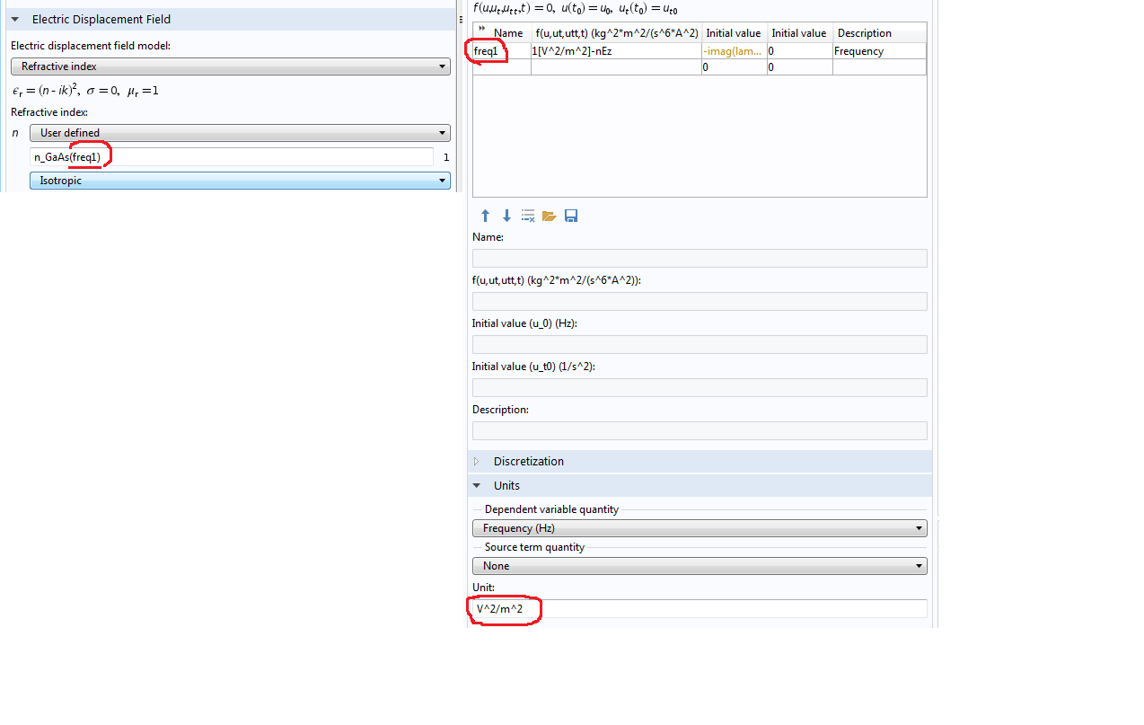

Hi, have you figured out the problem of calculating the bandgap of photonic crystals? I'm also encountering some problems when studying the case of Optical waves "bandgap_photonic_crystal.mph." About the case, I have some questions:
1. the corresponding PDF of bandgap_photonic_crystal.mph says that the refractive index of GaAs is frequency dependent, and the setting of "wave equation, electric 2" gives n_GaAs(freq1), while "freq1" has the dimension of intensity of electric field V^2/m^2, could you explain this?

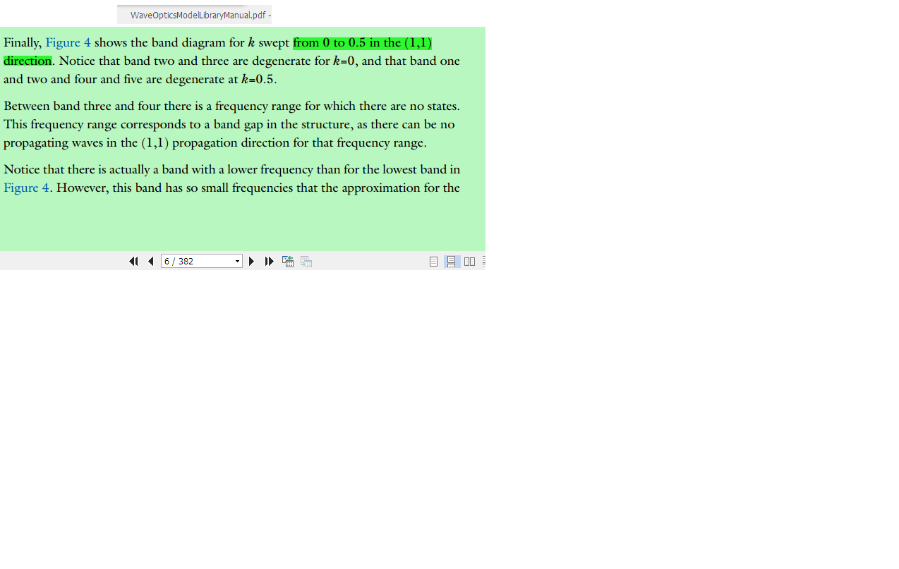

2. In the sixth page of "WaveOpticsModelLibraryManual.pdf", figure 4 gives the band diagram for k swept from 0 to 0.5 in the (1,1) direction. But i cannot find the corresponding settings standing for the (1,1) direction in bandgap_photonic_crystal.mph. could you tell me where the corresponding settings standing for the (1,1) direction in bandgap_photonic_crystal.mph are? or could you tell me how to figure out the whole band diagram of photonic crystal including Gamma--M--K--Gamma, just like the band diagram given by Rsoft?

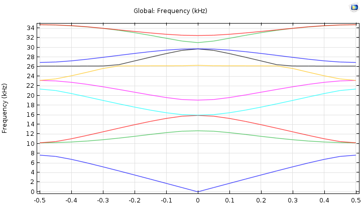

Dear Nagi
really thank you very much i have calculated the band strcture of my system as in the attached figure ...
but i have a problem in the wave vector axis , i want it to take the coordinate (M X) of the first brillion zone ...
also i want to calculate the transmission ..
thank you
