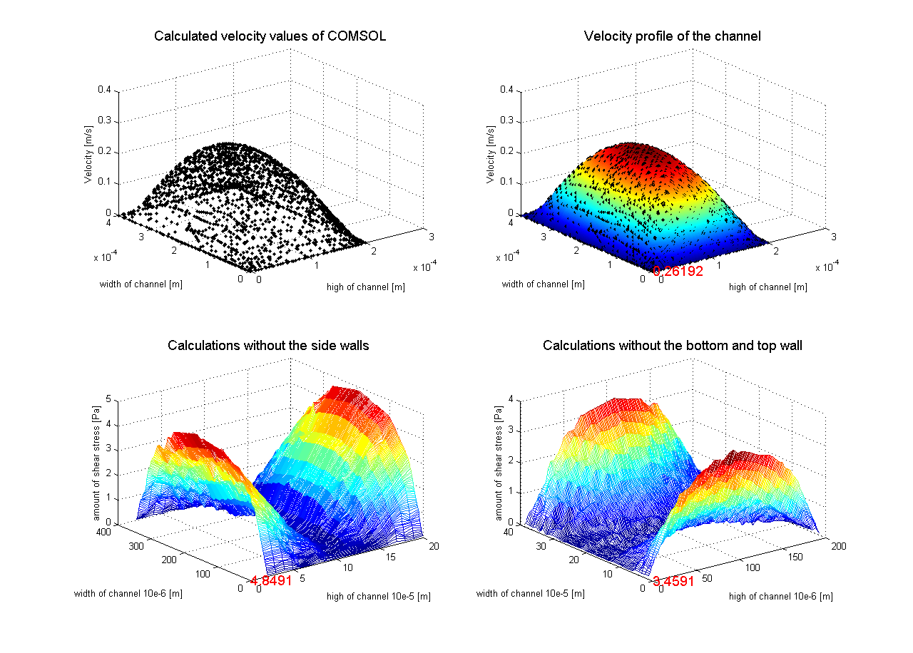

If you have a 3D model you can extract one velocity slice and do further calculations in matlab. I calculated the shear stress along the X and Y axis, one result is attached. Of course, this result is partly wrong because only the effect of 2 of the 4 walls is noted. But I think that the calculations are good directly at the middle of the involved walls, because there is less effect of the other walls. As further as you go to the edges or in the middle of the channel, the effect of the not noted walls increases and the results get huge error. But this could be a way to get your maximum shear stress values with a small error because the maximum values should be located in the middle of each wall.

I just implemented it in comsol with the result I added (first two pics).
The velocity profile looks fine. The shear stress not really. The stress values at the bottom and top wall are acceptable but the stress on the sidewalls is wrong I think.

Hi Tyler Regarding your answer I have a question. Is it allowed to just sum up the stress???? You mention that for 2D cases you use eta*(uy+vx). So if that is right, for 3D cases the formula eat*abs(vx) + eat*abs(uy) + eat*abs(wz) would be right as well???? I just implemented it in comsol with the result I added (first two pics). The velocity profile looks fine. The shear stress not really. The stress values at the bottom and top wall are acceptable but the stress on the sidewalls is wrong I think. So if I sum up all components eta0*abs(vy) +eta0*abs(uy) +eta0*abs(wy) … + eta0*abs(vx) +eta0*abs(ux) +eta0*abs(wx) … + eta0*abs(vz) +eta0*abs(uz) +eta0*abs(wz) the third profile is calculated, but I am not sure whether summing up all individual results is allowed? Do you have any advice? Thanks for any further help. T. Gumbel
