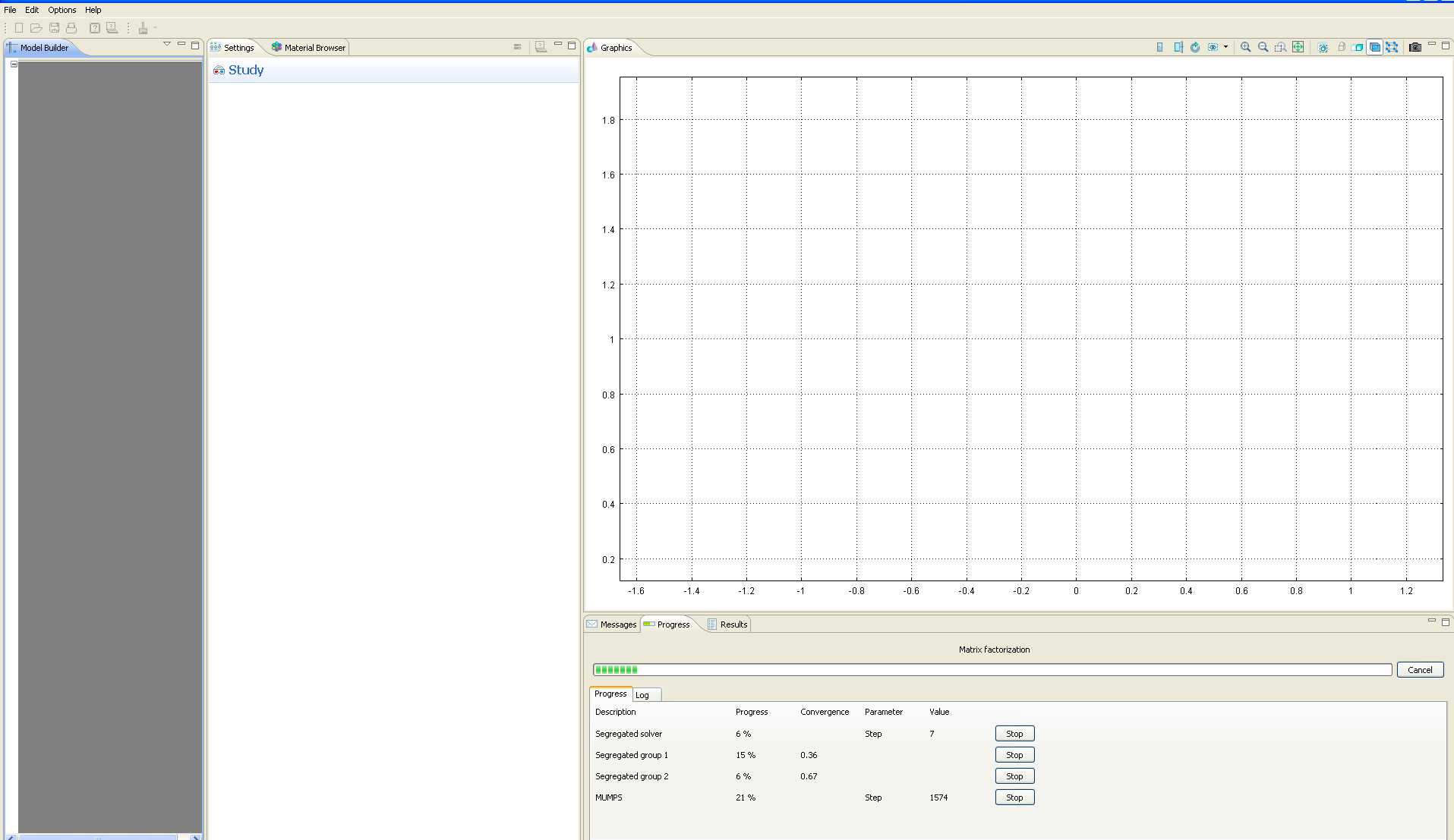

I am facing a problem with Model builder window in COMSOL 4.0 & 4.0a. When I minimize the Comsol file and open it again, I lose model tree in Model builder window. It just shows the background (desktop or another file behind the current Comsol file) in place of Model tree.
Though it is a small problem and doesn't affect either solution or results, its annoying when I open two Comsol files, it shows one Model tree in place of another file's model tree.

Thanks for your reply. I am attaching the screen shot here, in which I was running a Comsol model in V4.0a, minimized the window, then opened it again, and the model tree was not displayed in the Model builder. You can see the grey background in the model builder window in this picture is the file I opened in between minimizing and re-opening Comsol file.

I see. Well, to my guess there can be two problems. Try chaning the window manager (e.g. to Swing) in the settings menu. Second, make sure you have the latest Java version.
