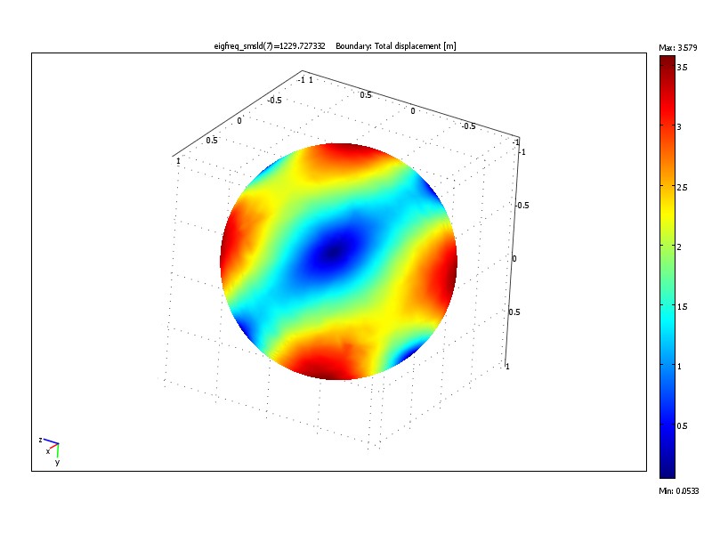

Structural Mechanics Module ->Solid, Stress-Strain -> Eigenfrequency analysis -> create a solid sphere of 1m -> set boundary constraint condition as Free -> Set Subdomains with default setting (E=2.0e11); v=0.33; a=1.2e-5; p=7850), Material model as isotropic; Coordinate system as global coordinate system; ->initialize mesh - Solve eigenfrequency -> that is.
I used Slice (predefined quantities=total displacement) to check all the frequencies found from 0-4000Hz, but were not able to find the breathing mode...
did I do anything wrong here? Help please

(4) another thing I questioned about the result from comsol was that if you looked at my attached image of 1229Hz mode, the total displacement of sphere at that mode could be up to 3.5m for a R=1m sphere. does that make sense? it seemed to em the oscillation amplitude should not be that big...

Back to your 3D simulation, I repeated it quickly, default 1m radius sphere, no BC, default material steel. I meshed it rather "finer" with 55000 elements and 231873 DoF's. It took 352 seconds on 8 core for 9 GB ram in direct defauilt settings mode. I asked for 26 first eigenmodes, and what do you see:
Observe the mode shapes in "Slice" mode with 3/1/1 slices and alternatively in "Boundary", with "Deformed" shape ON
I get 6 modes close to "0" Hz, these are the 6 free-free DoFs, as expected;
then 5 modes around 1232+/-0.5 Hz, the shape appears rather spheric with several hills appearing, allthough the numerical values shown are large, but this could be a mode normalisation effect
then 5 modes around 1305+/-0.5 Hz, the sphere show large elliptic deformations, more like an egg,
then 2 modes around 1767 Hz, 1 at 1777, 2 at about 1900, 2 at 1903, 2 at 1905 and one or more at 1912 Hz
