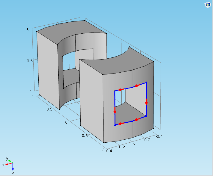

I have designed a simple curved saddle coil pair in Comsol directly by using some blocks and boolean operators. After adding "Magnetic Fields" as physics to that component I created two domain multi-turn coils and switched the coil type to "circular" because I want the current flowing along the edge you can see in my attached image file. My problem is that I can not find a way to manipulate the current direction in this specific model because Comsol seems to choose the direction on each edge automatically. Like you can see in the screenshot (attached file) the resulting current direction is not circular anymore. The edge direction changes on the given path. I tried to solve this problem by using virtual operators but I could not find a solution until now. I hope anybody is able to help me.

the "Coil Geometry" sub node has undergone a few changes over the last versions so you need to check your ACDC doc carefully.
Normally you should select a "rounded/fileted edge" shape giving the average length of the coil. In your case you have sharp edges and just the internal section, therefore your coil length calculations will be quite wrong, and the loop arrows look also wrong indeed. You could draw a loop (circular or a rectangle with fillets) in the middle of your volumes.
But it looks like you have a deformed coil wit a non planar shape, not sure how to correctly define that. Probably you should send the request directly to "Support".

You are right. It is a deformed coil with a non-planar shape - a saddle coil. I solved the problem by using the multi-turn coil type "numeric" and added a work plane to cut my model for creating a cross section. It is required to select the input of the input subnode of the automatic current calculation subnode. An electric insulation subnode is also required in which I selected all boundary faces of that coil. Furthermore I added appropriate coil current calculation steps to my study.

Kindly upgrade your COMSOL to 5.1 version, wherein you have the advantage to provide the coil current direction specifically which is presently not available in lower versions. (i guess you are doing a differential type of saddle coil).
