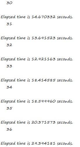

I just use the "tic" and "toc" to test the time consumed in each sweep.
The weird things happens!
As you see in the figures in the attached files, when k<33 , the time consumed is nearly same, about 13 seconds.(fig1.jpg, fig2.jpg). But when k> 34, the time consumed in each sweep increased significantly(fig2.jpg, fig3.jpg). when k = 55, it almost takes 199 seconds for one sweep(So weird). and After it, the sweep for k=56 stoped without any error message, but the comsolserver CPU is 0%(fig4.jpg).
