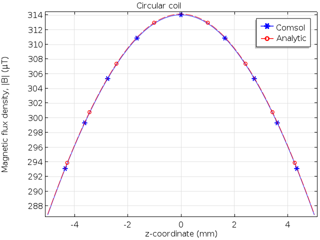

Alessandro,
Attached is model file with comparison to analytic solution.
Sergei
Alessandro, Attached is model file with comparison to analytic solution. Regards, Sergei

Alessandro,
Attached is verification model in v.4.3.
Sergei
Alessandro, Attached is verification model in v.4.3. Regards, Sergei
