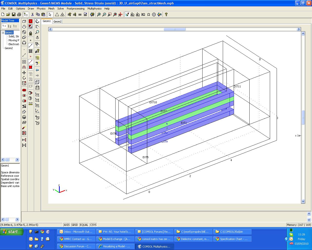

Here's what I tried. I draw my 3-D structure by first defining a 2-D workplane (call it G2) and then extruding it to 3-D (call it G1). I have attached a screen shot of G1. The big block at the bottom is a substrate, the block above it is air. The coloured U-shaped blocks are various materials, the uncoloured U-block is air. The various sub domains are a misguided attempt to manually divide it into rectangular blocks (cuboids).
Now I tried to extrude the mesh, along with the structure geometry, but I can't figure out how to do it. I basically have to extrude multiple shapes corresponding to the U section, substrate and air that I draw in G2. When I create a rectangular mesh in G2 and extrude it, it creates multiple work planes, with each mesh being in a different work plane. I can't seem to reconcile the workplanes.
Alternately, say I create the bottom U section in G2, define a mesh and extrude the mesh to G1. If I change to draw mode, I see that the geometry boundaries match the mesh. Then, if I try to copy the structure by using the array command, the geometry copies, but not the mesh.
How can I extrude, or sweep or copy the mesh in this kind of exercise?
Even if I have the mesh for all 4 U sections, how do I then generate a mesh for the substrate (which has the bottom plate of the bottom U section on its top boundary) and air (which contains all the U sections) using any of these techniques?

In that screen shot, if I try to generate a swept mesh in the substrate by sweeping from the front face to the back, or one side to the other, I get an "invalid topology" error. I can only guess this is because the top surface (which is not the source or destination in the sweep) has a boundary with the U section above it. But you say this should not be a problem?

Most probably you are not doing anything "wrong" it's just that you are hitting some of the limitations in 3D meshing and need to find a way around it. If you sweep a mesh and have a topology change, COMSOL need sto "decide" what to do, at that bifurcation, but it cannot, you must do it explicitely yourself.
The easiest is then really too redesign your volume with internal boundaries such that you have simple topologies, by sections, then you will manage to mesh your structure.
I agree this is rather cumbersome in V3.5 as you cannot save your meshing strategy, to rerun it later, you must note it down, and for complex geometries it can become very lengthy. For that V4 is far better as your sequence is stored and you can come an edit it at will.
