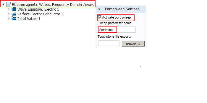

Hi, Is Comsol able to calculate the S-parameters of multiports in s single computing ?
For example, if i want to know s11 s21, s12 and s22 , i have to first set port 1 on port 2 off and compute to get s11 and s21, then manually set port 1 off port 2 on to compute s12 and s22, it there an automatic way to do this ?

Yes, there is an automatic way to calculate full matrix of S-parameters. In the Settings window for the “Electromagnetic Waves, Frequency Domain (emw) root node, there is section “Port Sweep Settings” where you can check “Activate port sweep” option, as shown in the attached image. This will allow you to perform sweep over the one active port at a time and extract full S-matrix using Global evaluation node.
Sergei
Cris, Yes, there is an automatic way to calculate full matrix of S-parameters. In the Settings window for the “Electromagnetic Waves, Frequency Domain (emw) root node, there is section “Port Sweep Settings” where you can check “Activate port sweep” option, as shown in the attached image. This will allow you to perform sweep over the one active port at a time and extract full S-matrix using Global evaluation node. Regards, Sergei
