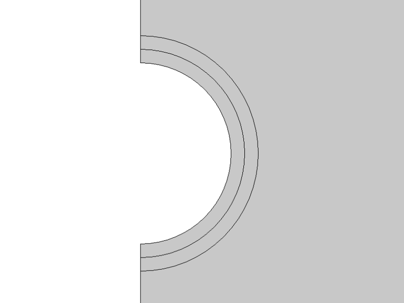

Thank you for the suggestion sir,
But, See the image attached.
I have tried what you have suggested.
Here I A have 2 concentric spheres (say s1 and s2 starting from the inner most one) over which a fluid is flowing . I have applied your suggestion of 2 diffusion coefficients in the 2 domains and on the outermost surface I have used a flux condition as fluid is flowing over.
my doubt is what condition should I specify at the inner most boundary of s1? 'No flux' condition is not working in my case. There my concentration is a function of time. I have searched a lot but I didn't get any appropriate analytical expression for time dependent concentration.
Can you provide any help in this case?
Thank you for the suggestion sir, But, See the image attached. I have tried what you have suggested. Here I A have 2 concentric spheres (say s1 and s2 starting from the inner most one) over which a fluid is flowing . I have applied your suggestion of 2 diffusion coefficients in the 2 domains and on the outermost surface I have used a flux condition as fluid is flowing over. my doubt is what condition should I specify at the inner most boundary of s1? 'No flux' condition is not working in my case. There my concentration is a function of time. I have searched a lot but I didn't get any appropriate analytical expression for time dependent concentration. Can you provide any help in this case?
Posted: 10 years ago 2015年11月24日 GMT+1 08:30
I thought that the inner sphere is the source of the diffusing species, but in your image that is an empty cavity, i.e. it is not a part of the simulation domain?
If you need a time dependent concentration at the inner boundary, define an appropriate function under
Component --> Definitions --> Functions
Let's assume that you have defined a piecewise function that is named "pw1". Then, at the boundary call it as pw1(t).
