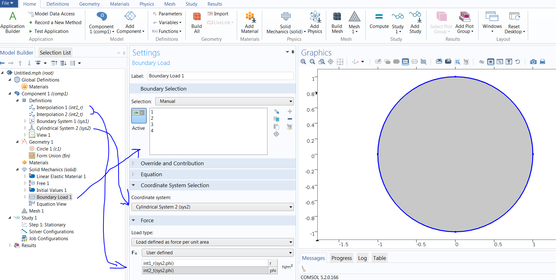

well I might not have understood you question correctly either ;)
But if you have two interpolation functions (r: radial and t: tangential): f_r(phi) and f_t(phi) you can define a boundary load in Cylindrical coordinates, with both functions, something like on the image attached
Hi well I might not have understood you question correctly either ;) But if you have two interpolation functions (r: radial and t: tangential): f_r(phi) and f_t(phi) you can define a boundary load in Cylindrical coordinates, with both functions, something like on the image attached -- Good luck Ivar

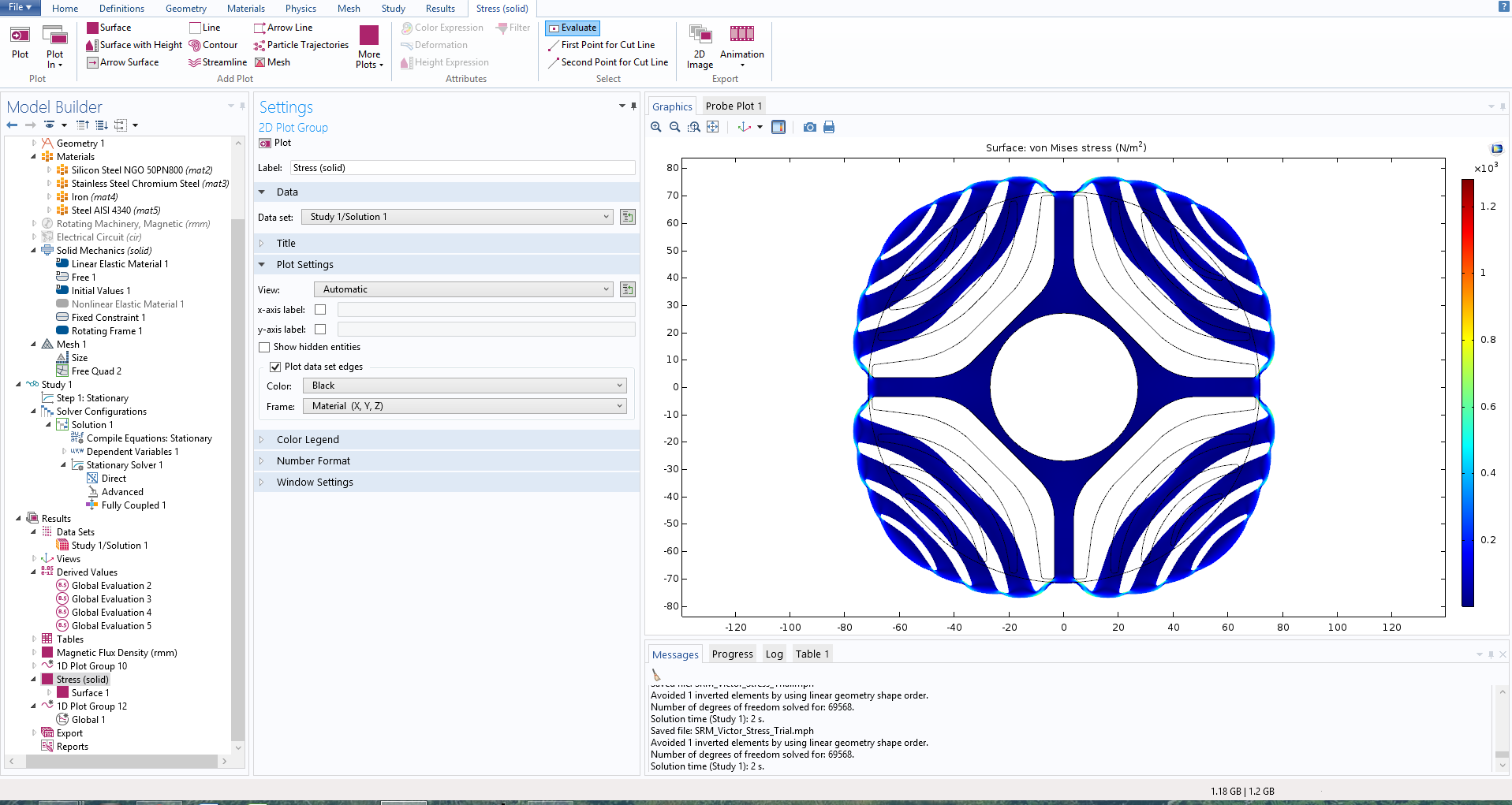

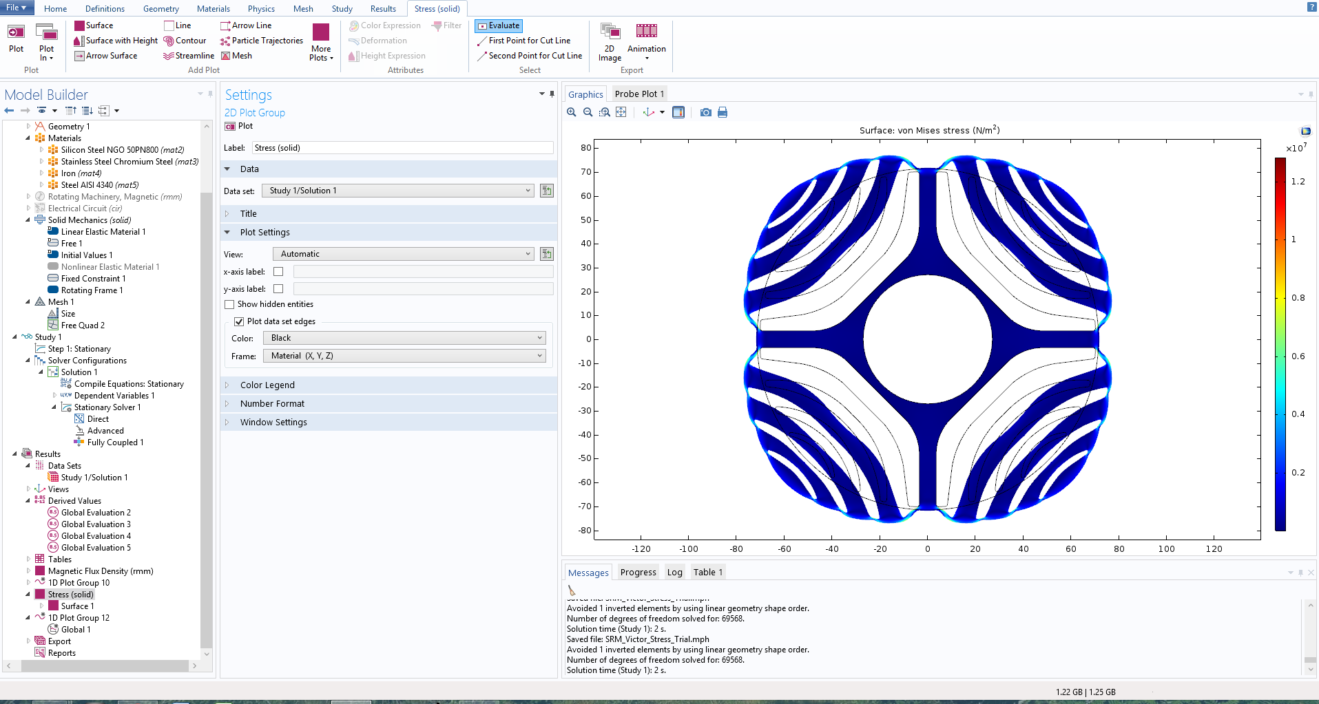

very thanks. Yes that was exactly what I meant. Right now I am coping with another issue. Or maybe it's not as in the beginning of my thread. Nevertheless my doubt is the following:
I load my model only with centrifugal forces using Rotating body frame. Imposing different speeds in rpm I get different values of Von Mises stress mapped all over the domain. However the solid displacement seems to be exactly the same. As you can see from the figures attached at 10 rpm and 1000 rpm the displacement of the iron rotating structure is exactly represented in the same way in terms of dimensions.
Does this representation have to be trusted? To be more precise I am doing an elastic simulation only, therefore the displacement should show some kind of proportionality with respect to the rotating velocity applied in my poor opinion. Is there a way to get the maximum displacement out of the COMSOL result after the structural mechanics simulation?
Sincerely,
Nicola
Dear Ivar, very thanks. Yes that was exactly what I meant. Right now I am coping with another issue. Or maybe it's not as in the beginning of my thread. Nevertheless my doubt is the following: I load my model only with centrifugal forces using Rotating body frame. Imposing different speeds in rpm I get different values of Von Mises stress mapped all over the domain. However the solid displacement seems to be exactly the same. As you can see from the figures attached at 10 rpm and 1000 rpm the displacement of the iron rotating structure is exactly represented in the same way in terms of dimensions. Does this representation have to be trusted? To be more precise I am doing an elastic simulation only, therefore the displacement should show some kind of proportionality with respect to the rotating velocity applied in my poor opinion. Is there a way to get the maximum displacement out of the COMSOL result after the structural mechanics simulation? Sincerely, Nicola
