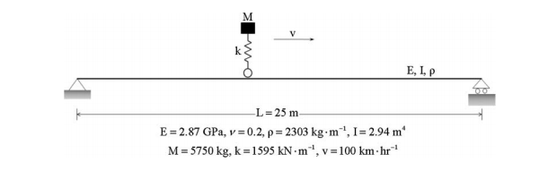

Or it can be done in 2D, doesn't matter. Attached is a diagram of what I am thinking.

you image looks more like a 2D beam problem, with a pinned - rolling BC for the beam, the material and beam, parameters defined E, nu, rho and L & I, and a moving mass M of velocity v with a spring Ky on a rolling point in contact to the beam.
So most of the physics is described, a few hypothesis are missing or considered implicit, I understand them as: the horizontal velocity of the mass M is NOT influenced by the spring, only the vertical Y axis motion of the mass.
A point remains open: should the rolling spring to beam contact be a one way contact and allow bouncing ?
I would propose to start with a fixed contact point and avoid "contact physics" as this is tricky to make to converge, then it should not be too difficult to check that the wheel is not bouncing and lifting off the bridge, if so, then its worth to try to implement a contact model as the vibrations of the beam will change drastically if the Mass gets disconnected.
I see two ways to implement the spring and mass,
1) use a point mass at the end of a small beam you adapt to have the right stiffness Ky, that is constrained to a constant velocity along X
2) add an ODE (or modify the Prescribed Displacement node) to describe the Ky & M combination on the contact point moving at constant Vx velocity via mechanics equations
