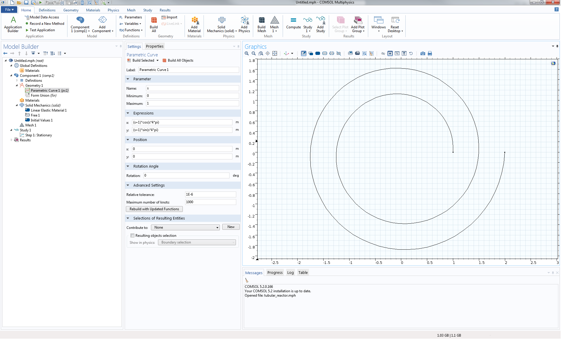

Is there anyone knows to draw spiral in 2D? I could find suggestions saying about drawing helix in 3D. But I purely want to draw in 2D. Kindly suggest me.

You can use a parametric curve, like in the attached screenshot, to specify a spiral.
Hello Vasantharajan, You can use a parametric curve, like in the attached screenshot, to specify a spiral. Best, Jeff

Hello Jeff,
Thanks for your suggestion, but that gives me a 1-D spiral. But I wish to draw a 2D structure like a coil. By your example, one could be able to draw a spiral with a known radial parameter, "s". But to draw a 2D spiral coil, we require two known parameters. Is there any option to use multiple parameters in the parametric curve?

Hello Jeff Hiller,
I tried with two parameters and got a structure as like in the image after the union and converting to solid. Now, I wish to adjust the thickness of the solid. But, to do so, I've to change the parametric curves, union them and then convert to solid, each and every time. Instead, is there any option to define parameter for the new solid? So that, we can directly vary the parameter of the solid.

Yes, COMSOL does support parametric geometries. Please read the Introduction to COMSOL Multiphysics manual, version 5.2, accessed through the File > Help >Documentation menu: the busbar tutorial illustrates this.
Yes, COMSOL does support parametric geometries. Please read the Introduction to COMSOL Multiphysics manual, version 5.2, accessed through the File > Help >Documentation menu: the busbar tutorial illustrates this. Best, Jeff
