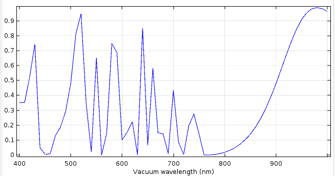

Can I swap the wavelength less than the period of structure?
I use the physic of electromagnetic wave frequency domain, and set period boundary on strucure. But when I use parameter swap module on study, there are always disorder results obtained like the attach flie in the wavelength less than the geometrical period of structure. This often happened in my study recently, but I remembered inaccrurately that it can be solved as the right solution before. What wrong may I make? What should be noticed particularly when solve a periodic structure in small wavelenth?Thank you for your adivce!
