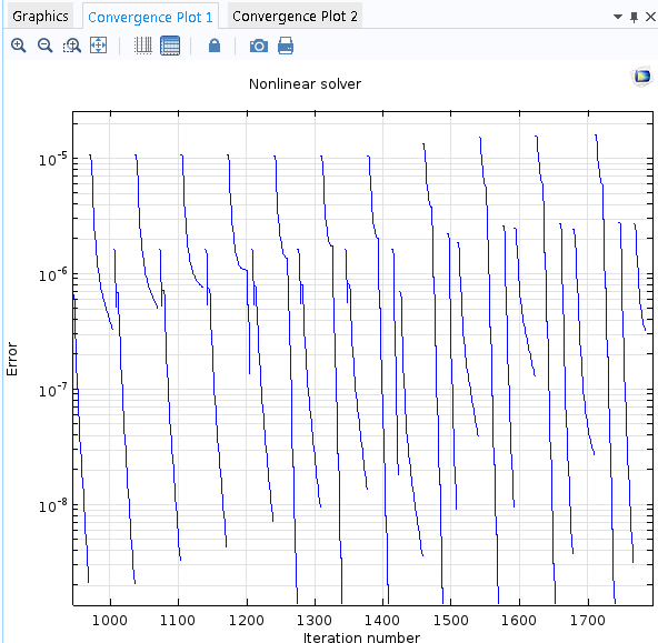

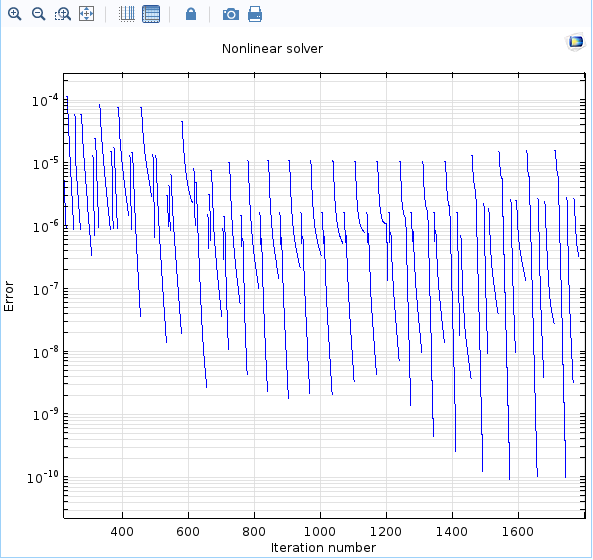

What I find quite puzzling is that the error seems to be quite small (see attachment), however the number of NLfailuers increases continuously showing that there is a problem.
