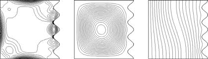

I am pretty new to COMSOL and I am working on Natural Convection In Cavities which is having either one wall or multiple wall having a simple Sinusoidal wavy profile or which might be having an equation .
I am attaching a sketch of a square cavity with a wavy wall for All for better understanding.
Does any body know how to build this by using COMSOL Geometry?

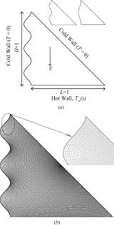

THANK YOU SO MUCH!!! CAN I MODEL A TRIANGULAR ENCLOSURE(fig attached) By this same method?
Posted: 9 years ago 2016年5月23日 GMT+2 21:02
Of course, just replace polygon with an open triangle.
Br
Lasse
Of course, just replace polygon with an open triangle. Br Lasse
