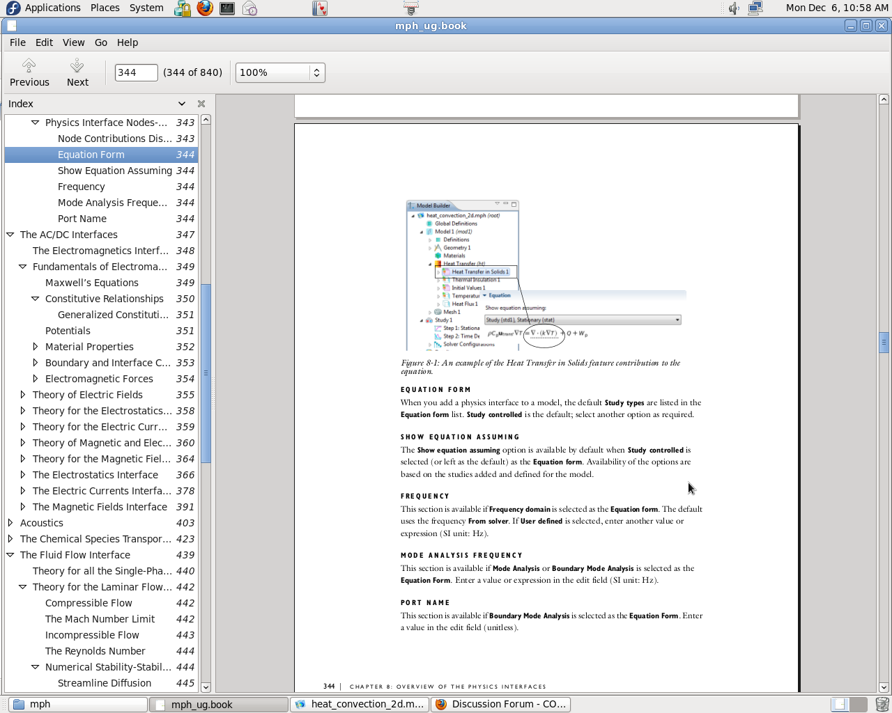

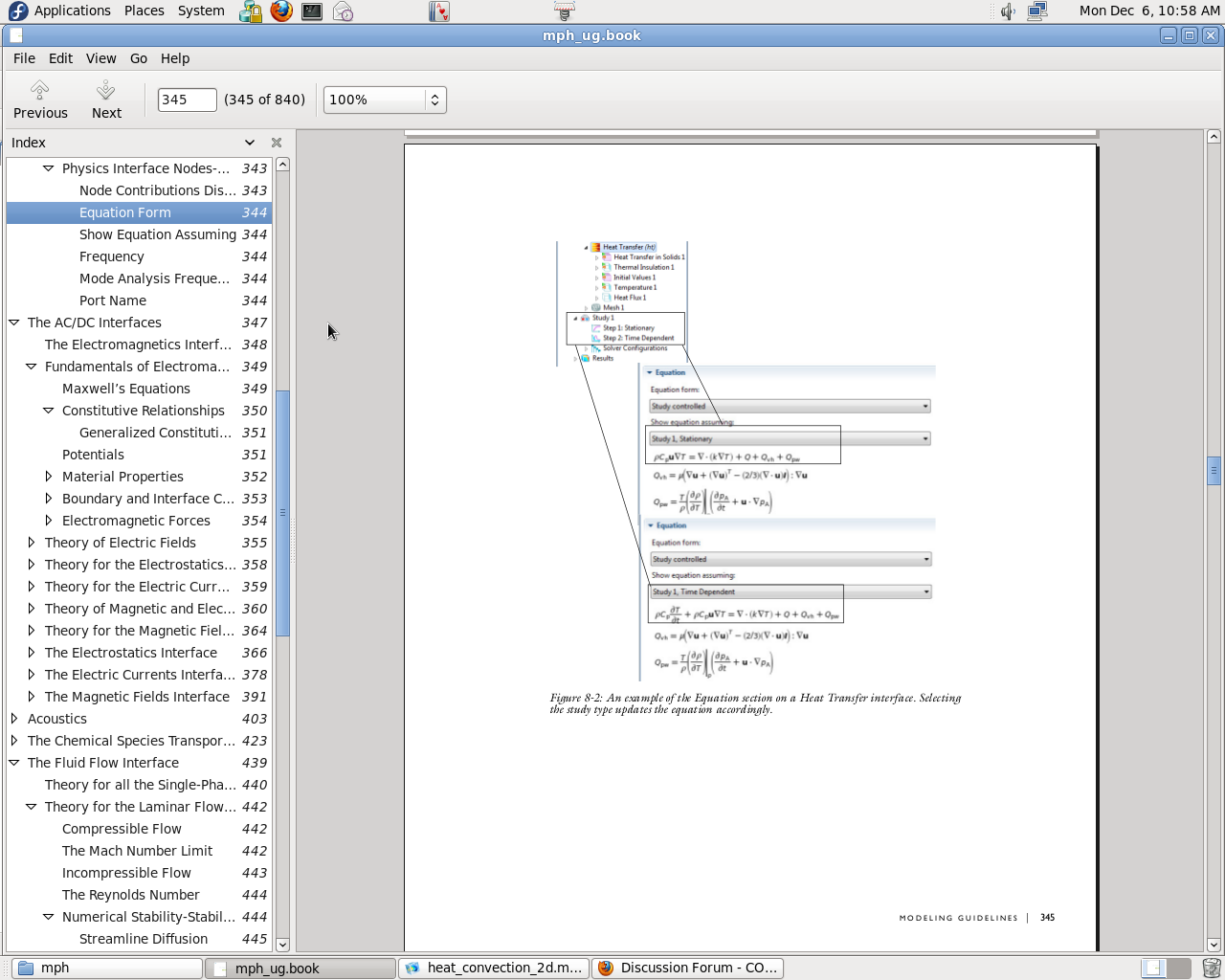

On page 344 and 345 of the COMSOl 4.1 user's guide manual, an equation form is being shown. No matter what I do, I am unable to see the equations as shown in Fig 8-1 and 8-2. I am wondering if someone can tell me how to get COMSOL to show the equations as displayed in the manual.
I am also attaching a picture of what I am talking about.

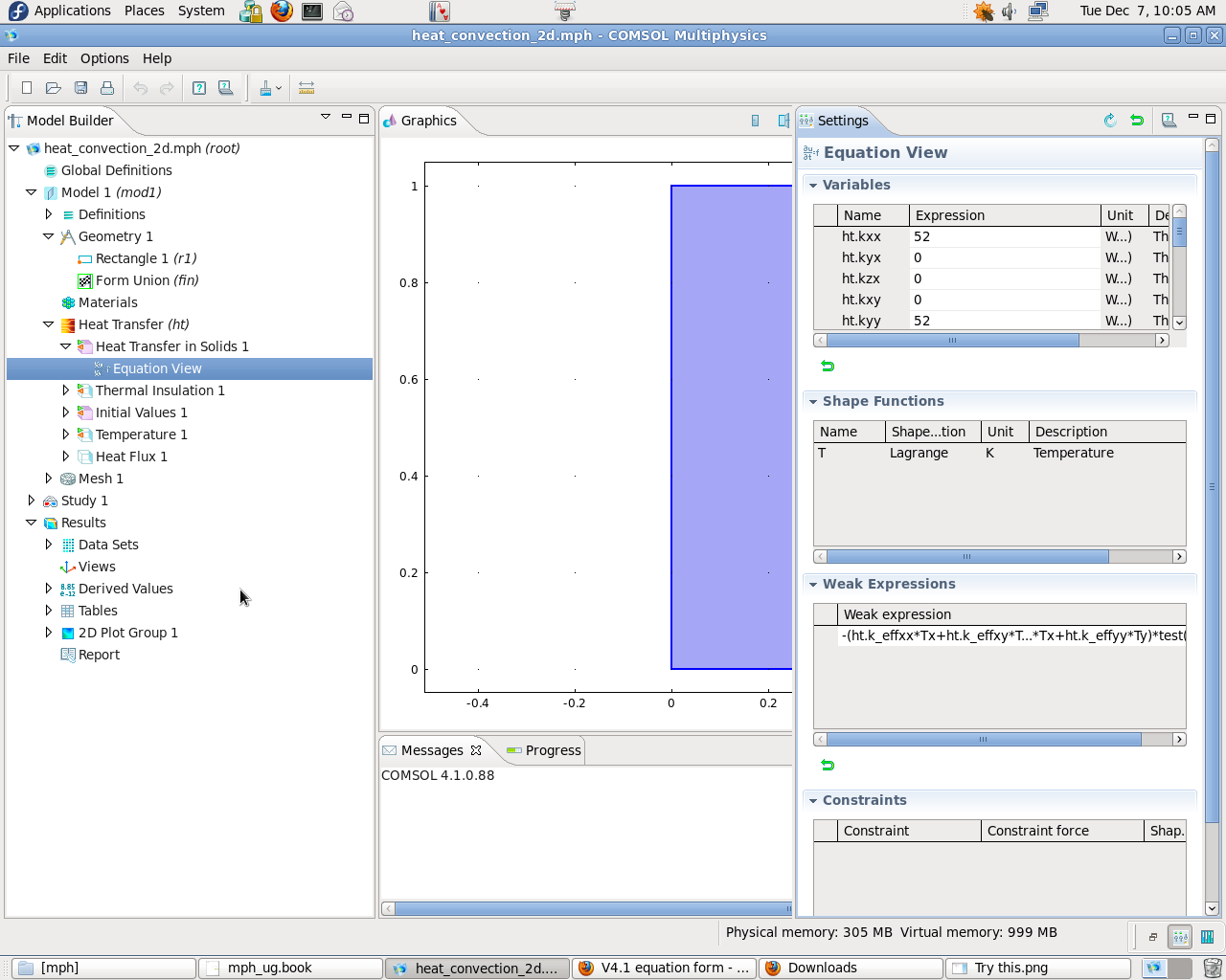

Hi there, have you tried this? .... (see picture)
Posted: 1 decade ago 2010年12月7日 GMT+1 17:06
I did and that's when I see what is attached to this message. This is not the same as what is shown in the manuals.
Sirisha
I did and that's when I see what is attached to this message. This is not the same as what is shown in the manuals. Sirisha

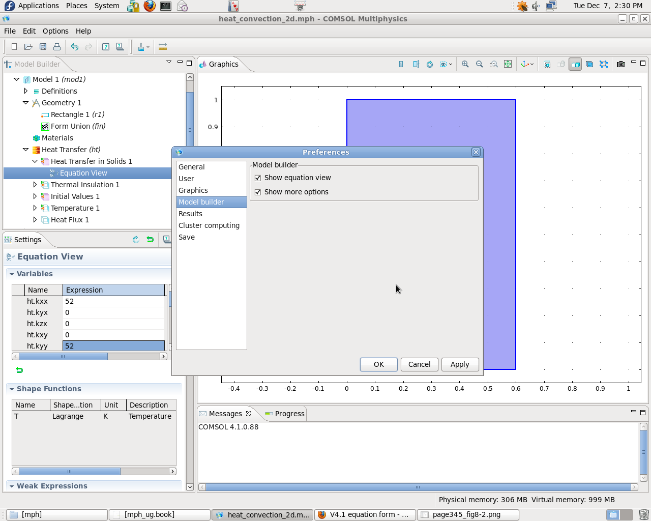

Thanks Ivar! But I don't see the option that you are talking about (options->preferences->equations).
I am attaching an image file of the options I have.
I already selected the "show equation view" and I still don't see the equations as shown in page 344/345 (image attached to one of the earlier discussions in this thread) of the user's guide. This particular page talks about equation form and I don't see what I need to do to activate this equation form.
I am wondering if this is something that is supposed to be a part of a future version and it accidentally made its way into the version 4.1 manual or is there something wrong with my installation?
Thanks for the help.
Sirisha
Thanks Ivar! But I don't see the option that you are talking about (options->preferences->equations). I am attaching an image file of the options I have. I already selected the "show equation view" and I still don't see the equations as shown in page 344/345 (image attached to one of the earlier discussions in this thread) of the user's guide. This particular page talks about equation form and I don't see what I need to do to activate this equation form. I am wondering if this is something that is supposed to be a part of a future version and it accidentally made its way into the version 4.1 manual or is there something wrong with my installation? Thanks for the help. Sirisha
