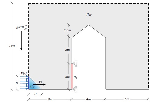

Thanks. When I open the file in 5.3 it works. The problem is that I want replace the old phisics (Two phase flow) with the new. When I try do rebuild model it doesnt't work. Specially when I introduce velocity condition becouse under gravity water collapse! Before it worken in 5.3 no. Why? You have some idea? Please help me :(
