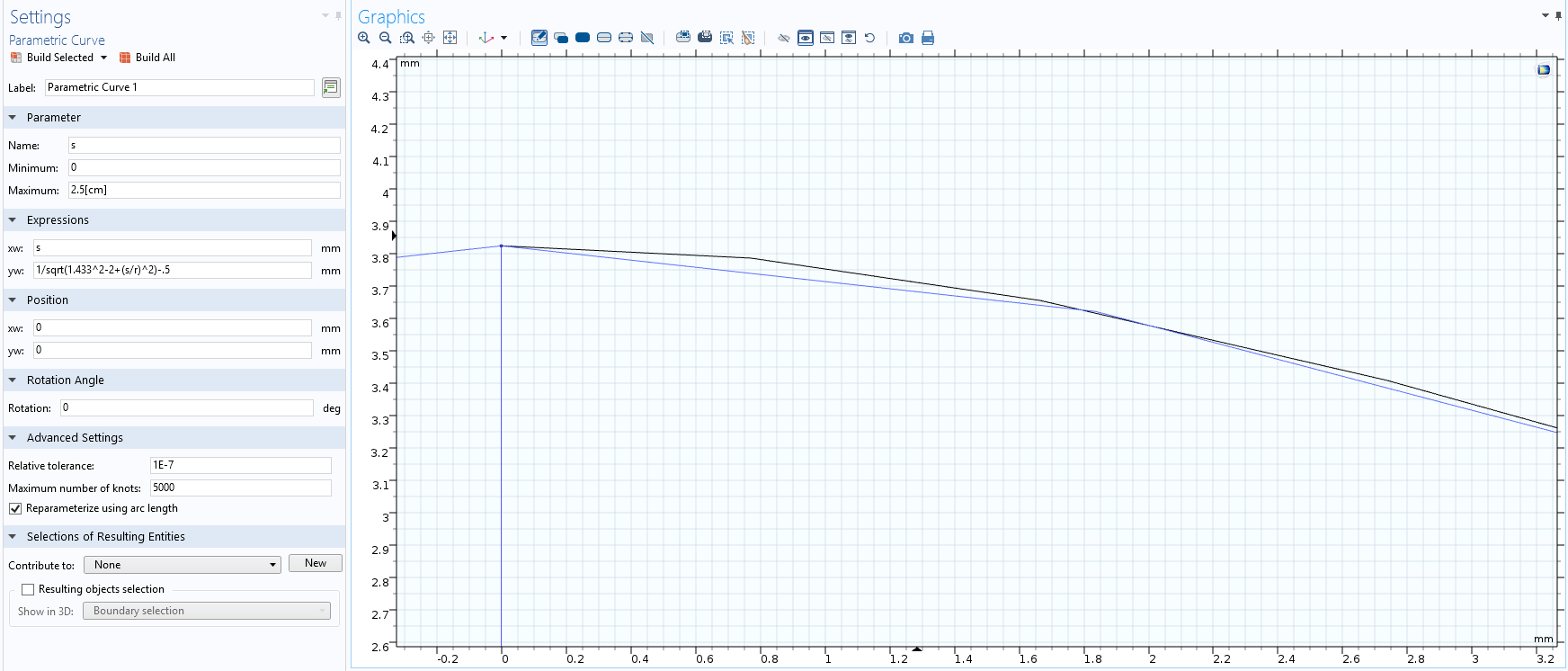

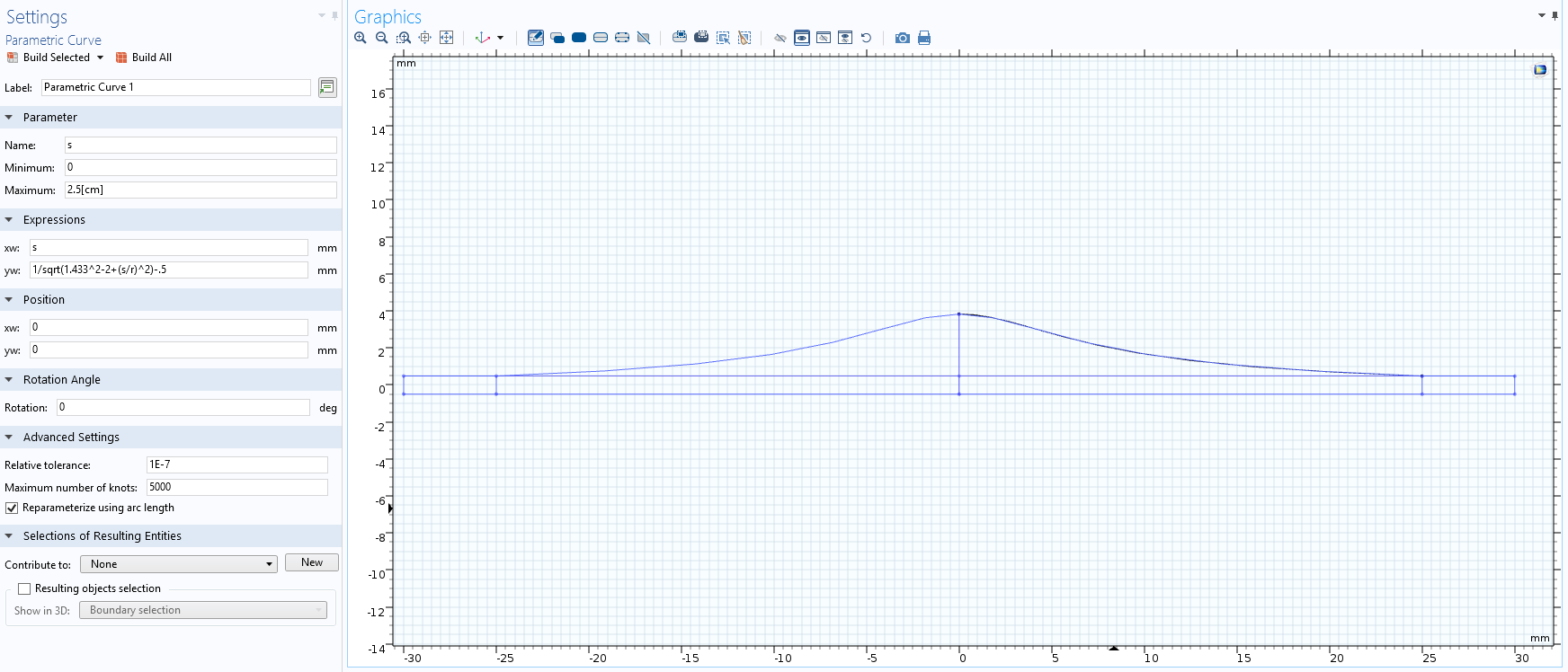

I have a created a parametric curve while creating a lens. But the smoothness of the curve is not good. can someone please help. I'm using Comsol 5.3 a RF module.

The black polygon you see in the graphics is just an approximation. You can improve it by going to Preferences > Graphics and Plot Windows and changing the preference Detail to Fine. When solving the model, a smooth curve is used, and its accuracy is not affected by the resolution of the approximate polygon used for visualization.
