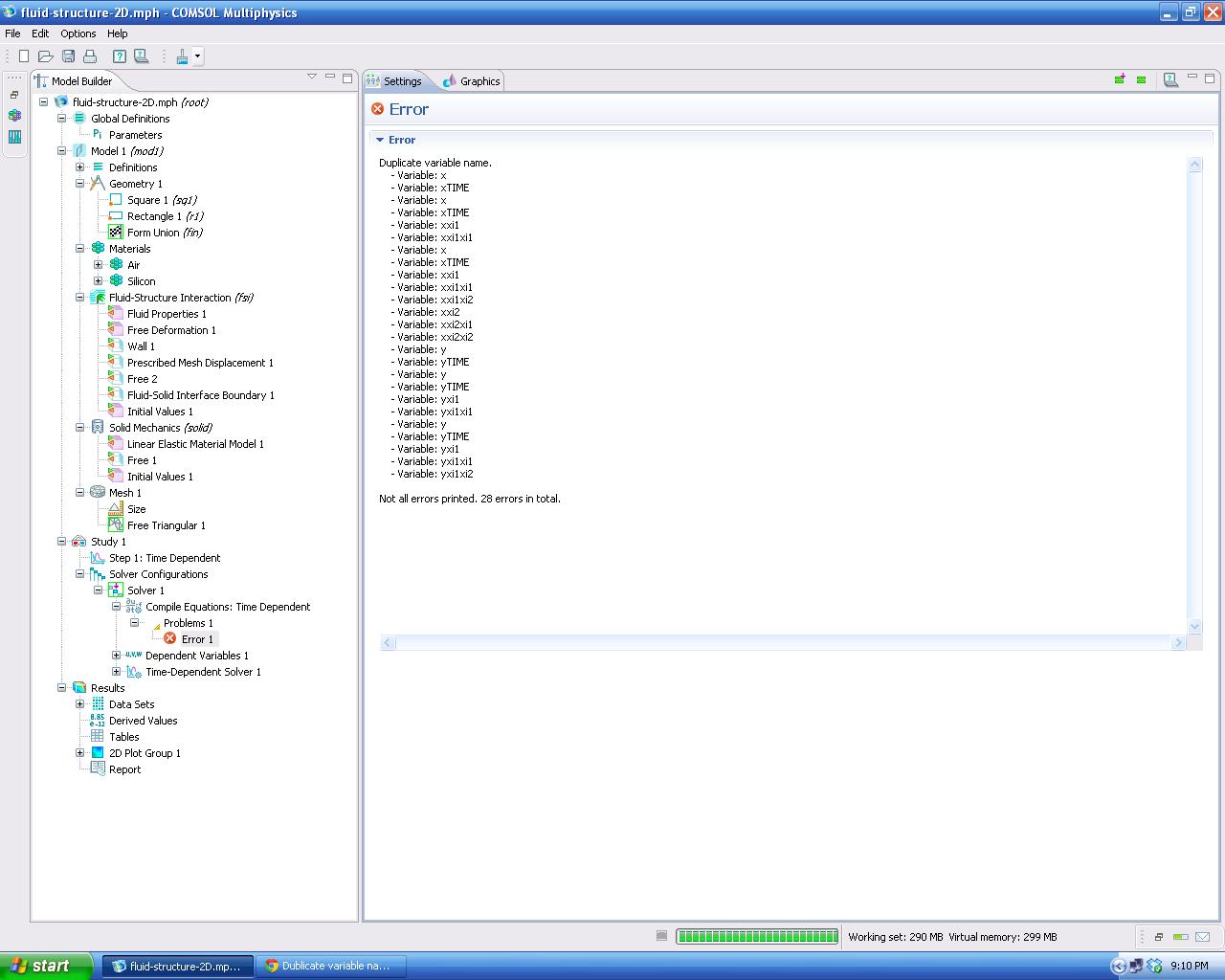

I am getting a duplicate variable name error (see attached). Any help is very much appreciated.
Jim

it's most probably because you have FSI which contains "structural solid" physics and "Solid" physics in the same model. You are duplicating many features, and if you do not use different dependent variable names you might get "duplicated names" error. Still the names on the list are puzzling, they are coordinates and not dependent variables.
Anyhow, with FSI normally you do not need to add solid, as its already contained in FSI, under subsection Structural
Hi it's most probably because you have FSI which contains "structural solid" physics and "Solid" physics in the same model. You are duplicating many features, and if you do not use different dependent variable names you might get "duplicated names" error. Still the names on the list are puzzling, they are coordinates and not dependent variables. Anyhow, with FSI normally you do not need to add solid, as its already contained in FSI, under subsection Structural -- Good luck Ivar

COMSOL automatically identifies the boundaries that form the fluid-solid interface. In the model both domains seem to be defined as fluids. A first step here is to add, for example, a Linear Elastic Material Model node to domain 2 to represent the solid. The boundary selection in the Fluid-Solid Interface Boundary node is then updated to include the four boundaries that separate the solid from the fluid.
Magnus Ringh, COMSOL
Hi, COMSOL automatically identifies the boundaries that form the fluid-solid interface. In the model both domains seem to be defined as fluids. A first step here is to add, for example, a Linear Elastic Material Model node to domain 2 to represent the solid. The boundary selection in the Fluid-Solid Interface Boundary node is then updated to include the four boundaries that separate the solid from the fluid. Best regards, Magnus Ringh, COMSOL
