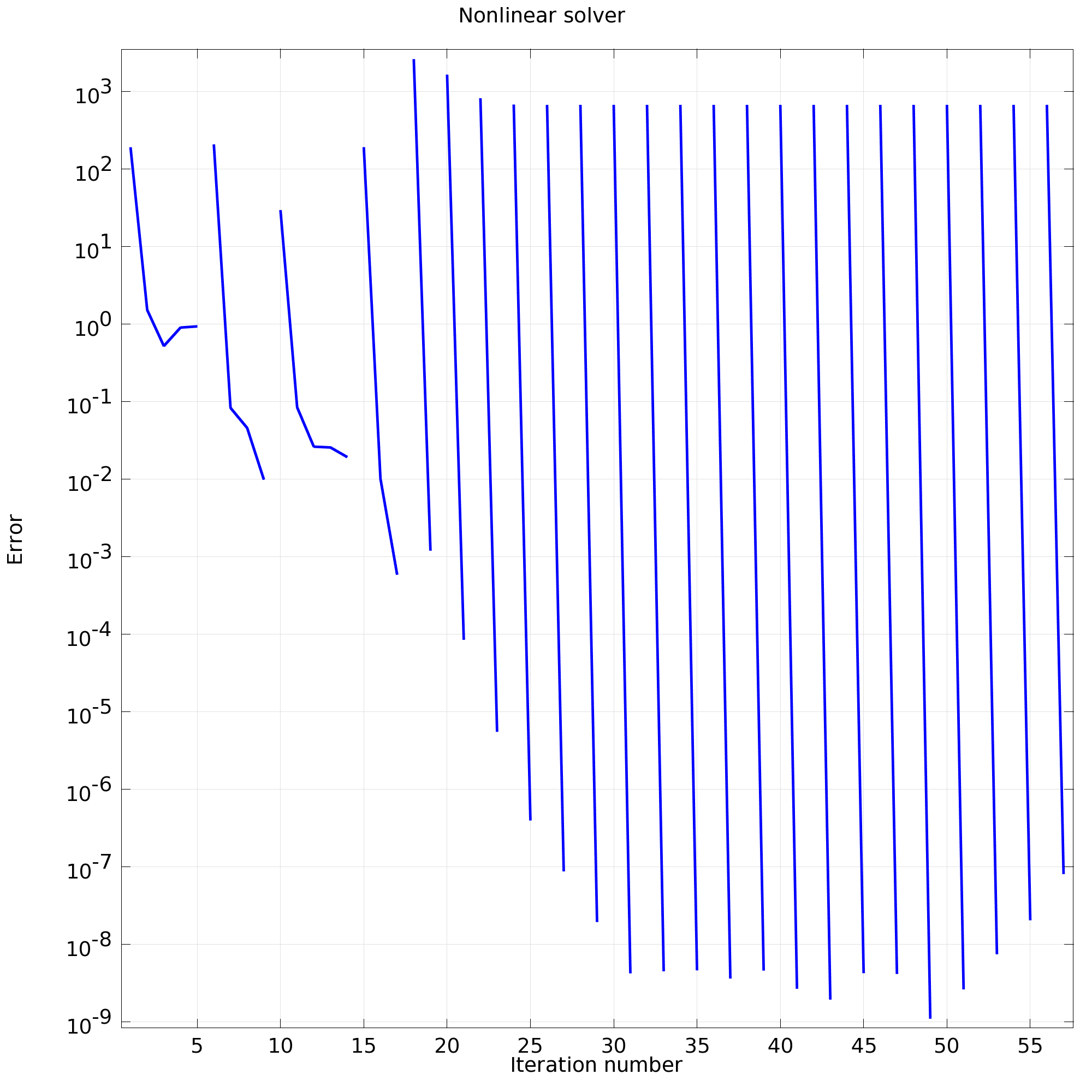

I'm getting this error when running a time dependent simulation of laminar flow in a micro channel. What I want to do is change the input flow on one arm of a y-channel and follow the response in time. Anyway it's this error:
Repeated error test failures. May have reached a singularity.
Time : 0
Last time step is not converged.
Now I've seen people with similar problems where it is due to too large a change in the time dependent parameter but I don't see how this is the case here. I am simulating for t=0 with the stationary solver first which is giving the correct result and at t=0 for the time dependent solver the boundary conditions should be exactly the same. I've tried several different time steps and different arrangements for the step function I'm using to change the flow. If it failed as the flow changed I'd think there was a point to the error but this doesn't make sense to me. Anyone have any ideas?

Posted: 1 decade ago 2011年9月29日 GMT+2 08:40
I did try to set the t as a parameter as you mentioned and then have it used as a built-in variable by the time -dependent solver but it gave me far too many problems so I simply cut the corner and divided the problem into two studies. When you open the solution of the time dependent one, if you defined everything correctly, you actually start from the steady state solution and you can see how it evolves over time.
If you manage to get the t-parameter work please let me know.
Regarding your convergence plot, it looks perfectly fine.
Cheers

I am a bit lost with everything was written lately but I did manage to have your t-junction to work properly.
First of all I coul dopen the file this time, I don't know why.
Second, I got rid of the t-parameter.
Third, I set two independent studies, first the steady state then the time dependent.
Fourth, I defined a new parameter Lentr= entrance length, which is given by Reynolds*0.06*diameter and gives the entrance length along which the flow profile develops.
Fifth, I enabled the Stokes approximation, since Re=0.38<1
Sixth, I disabled the distributed species analysis and I got a steady state solution.
Seventh, again without the diluted species analysis I got a time dependent solution starting with the stationary one.
In conclusion, I fine tuend a couple of parameters and I got rid of the diltued species to get a solution. I think you may want to have a look at that analysis because it seems to be the cause of the failrue of your simulations.

does this do the job for you ? (to understand how to use the parameter t and a boundary load depending on "t"
Its a simple model I load it with the stationary solver and then observe the oscillations with the time series, I defined the model in stationary and then added the time series BEFORE I ran the mode so that COMSOL looked after the coupling. To resolve the oscillations I need to use a shorter time step than the default defined one

back in v4.2 days we could not disable certain BCs for different studies, so I used there the trick to set the forces for the BC to "-100*1" for the stationary solver, since when the stationary solver runs, "t" is not defined yet by the time dependent solver, and my parameter "t" is used to set the Force to "-100" via the Boolean expression. Thereafter for the time dependent study, the force disappears from the first step t>0.
In v5.1 you would simply disable the boundary load for the time dependent solver and remove fully the Boolean expression the *(t[1/s]==0) means equal to "1" if t transformed to a number expressed in units of seconds "equal" to "0"
Hi back in v4.2 days we could not disable certain BCs for different studies, so I used there the trick to set the forces for the BC to "-100*1" for the stationary solver, since when the stationary solver runs, "t" is not defined yet by the time dependent solver, and my parameter "t" is used to set the Force to "-100" via the Boolean expression. Thereafter for the time dependent study, the force disappears from the first step t>0. In v5.1 you would simply disable the boundary load for the time dependent solver and remove fully the Boolean expression the *(t[1/s]==0) means equal to "1" if t transformed to a number expressed in units of seconds "equal" to "0" -- Good luck Ivar

Dear Ivar,
Thank you for posting the clarification. Since the original discussion is from 2011 and is regarding COMSOL version 4.0a, we will close this thread for further discussions.
As Ivar correctly notes, it is (as of several versions now) possible to activate and delete boundary conditions in different study steps.
Since the issue of inconsistent boundary conditions for transient fluid flow problems does come up quite often, there is now also this KnowledgeBase Article which will address such questions:
www.comsol.com/support/knowledgebase/1172/
