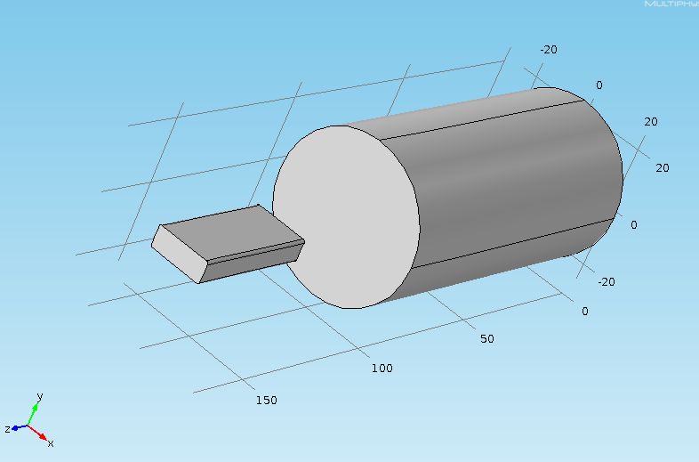

The Design Module (which did not exist when this thread was started) includes, among other things, two capabilities that makes creating this geometry a cinch:
- 3D filleting
- Lofting
I am attaching a screenshot illustrating those capabilities on your geometry.
The Design Module (which did not exist when this thread was started) includes, among other things, two capabilities that makes creating this geometry a cinch: - 3D filleting - Lofting I am attaching a screenshot illustrating those capabilities on your geometry. Best, Jeff
