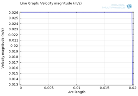

I draw a rectangular and do the laminar flow module, inlet 2.6m/s on one of boundary, then just run the study.
I plot the inlet\ velocity, to make sure the inlet velocity is 2.6m/s, but in COMSOL 4.2a it give me 0.026m/s.

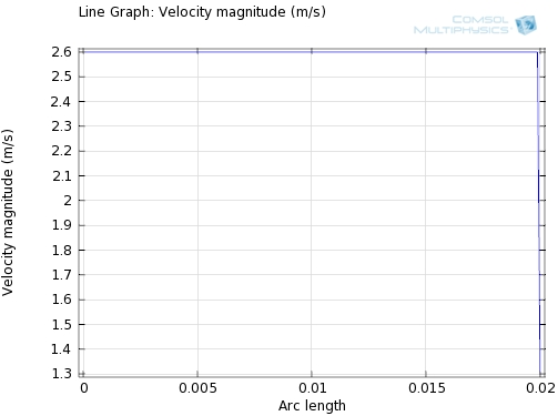

I ask my friend plot the same thing in 4.2, it return correct 2.6m/s.
Can somebody help me confirm it is a bug or my personal mistake? as it looks like postprocessing data in COMSOL 4.2a scale down the unit.
Thank you.

I apologize about the mistake.
The solution is i do not clear the solution in 4.2a and rerun it again.
now solve already.
sorry.
I apologize about the mistake. The solution is i do not clear the solution in 4.2a and rerun it again. now solve already. sorry.

indeed I would be astonished thaat you get such a "mistake" without other having noticed it ;) a factor 1000 is typically a unit error meters to mm, but could be other things.
One rule I do (at best) is to relaunch a fresh COMSOL for each new model, as when you delete an old one and rebuild, you are nwever 100% sure that ALL default variables are reset, there are so many inside COMSOL ...
Hi indeed I would be astonished thaat you get such a "mistake" without other having noticed it ;) a factor 1000 is typically a unit error meters to mm, but could be other things. One rule I do (at best) is to relaunch a fresh COMSOL for each new model, as when you delete an old one and rebuild, you are nwever 100% sure that ALL default variables are reset, there are so many inside COMSOL ... -- Good luck Ivar
