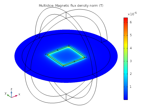

I'm new to comsol I have to build a rectangle coil and monitor magnetic field arround it. Coil type is not circular.
So i tried Conductor model : Homogenized multi turn Coil type : Numeric i'm stuck here . can anyone help ?

Attached is working model.
Sergei
Sanchayan, Attached is working model. Regards, Sergei

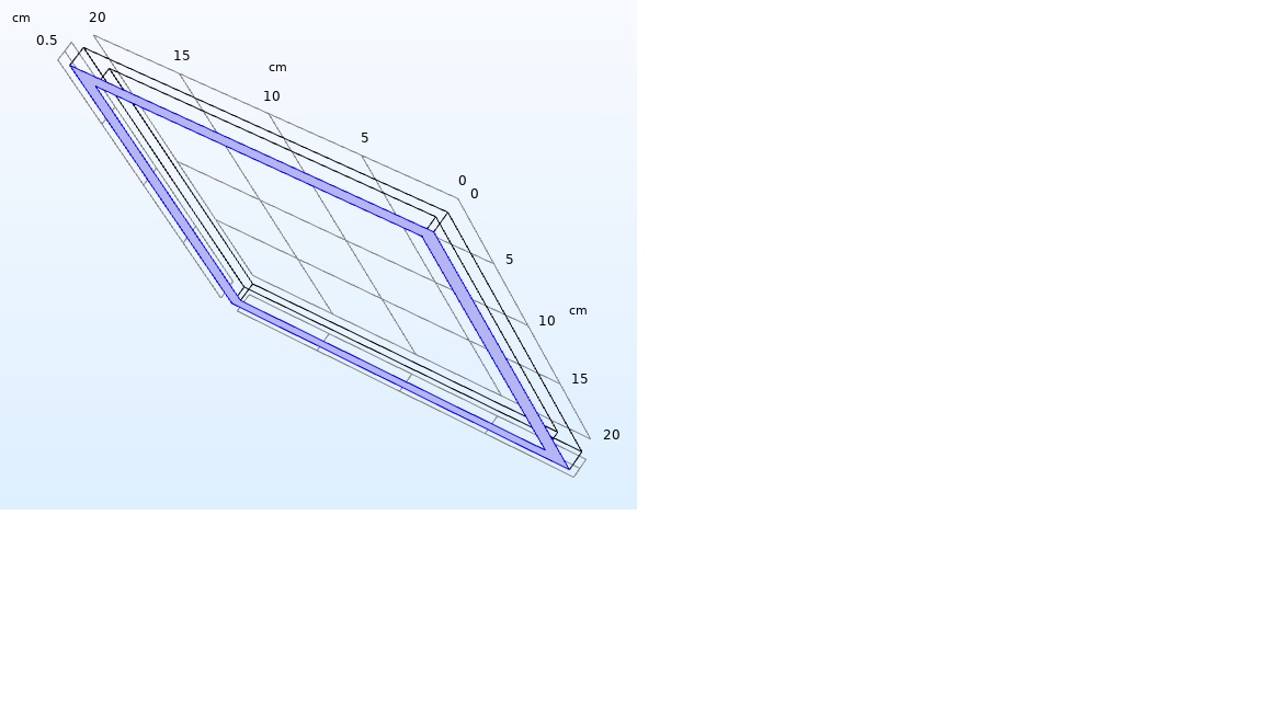

@Sergei Thanks for your time, but still i have issue. I'm simulating this result for the purpose of building a Gradient coil for MRI. Means i will end up using multiturns of coils. Your setting on conductor model is : Single conductor. How to implement it on multi turn coil.
When i implemented it on multi turn coil , i get the error " Could not determine the center of the circular coil ".

Attached is multiturn coil.
Sergei
Sanchayan, Attached is multiturn coil. Regards, Sergei

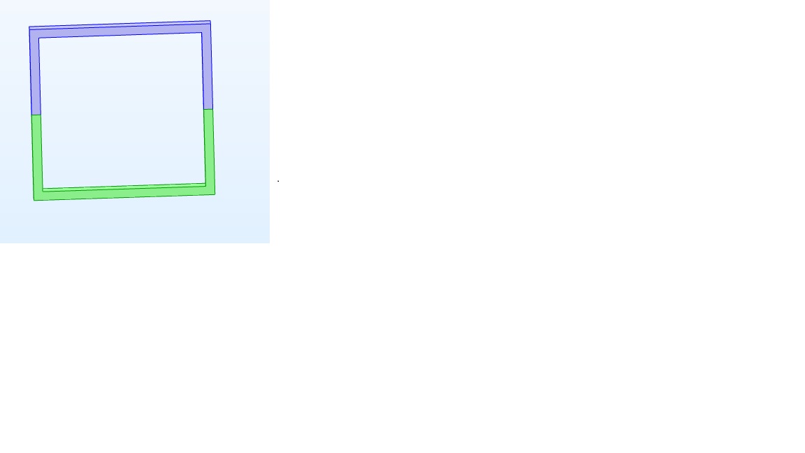

Can i ask a geometry question. At your model the selection happens on whole domain attribute. when im developing the selection happens on faces of the shape attribute. Where im doing it wrong.
Regards
>Sanchayan, > >Attached is multiturn coil. > >Regards, > >Sergei hei You have answered the original question. Big thanks.!!! Now im trying to build by myself more complex model. Can i ask a geometry question. At your model the selection happens on whole domain attribute. when im developing the selection happens on faces of the shape attribute. Where im doing it wrong. Regards
