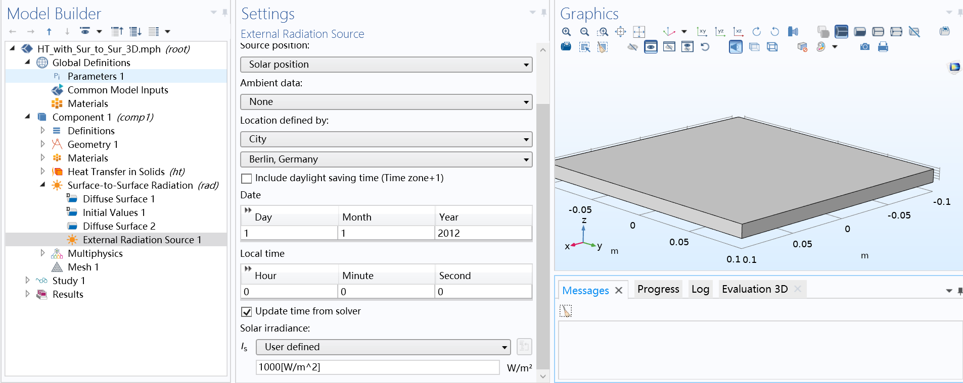

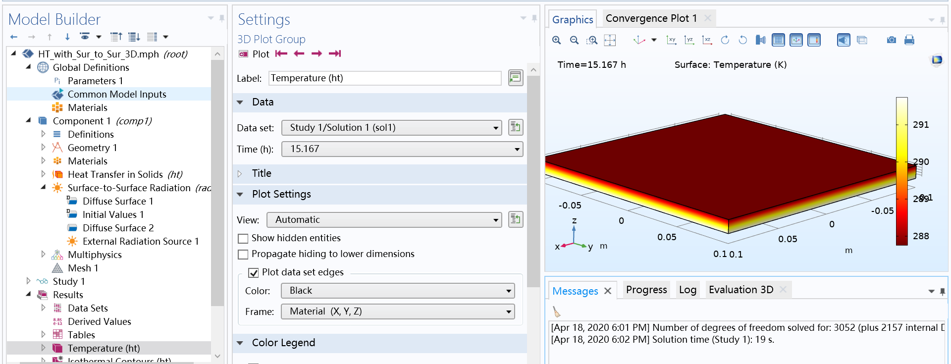

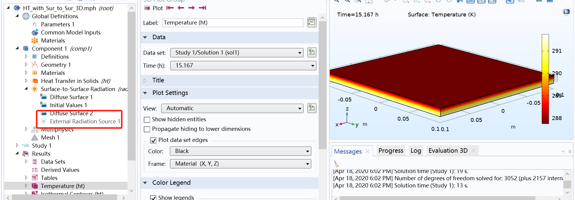

I am confused that when I add External Radiation Source it does not seem to work. When I disable that External Radiation Source the result does not change. Is there anything that I have missed?
Hi, There might be difference in the material in both cases. Did you set the boundaries differently, such as thermal insulation / emissivity? You can check if all other conditions are exaclty the same. I am confused that when I add External Radiation Source it does not seem to work. When I disable that External Radiation Source the result does not change. Is there anything that I have missed?
