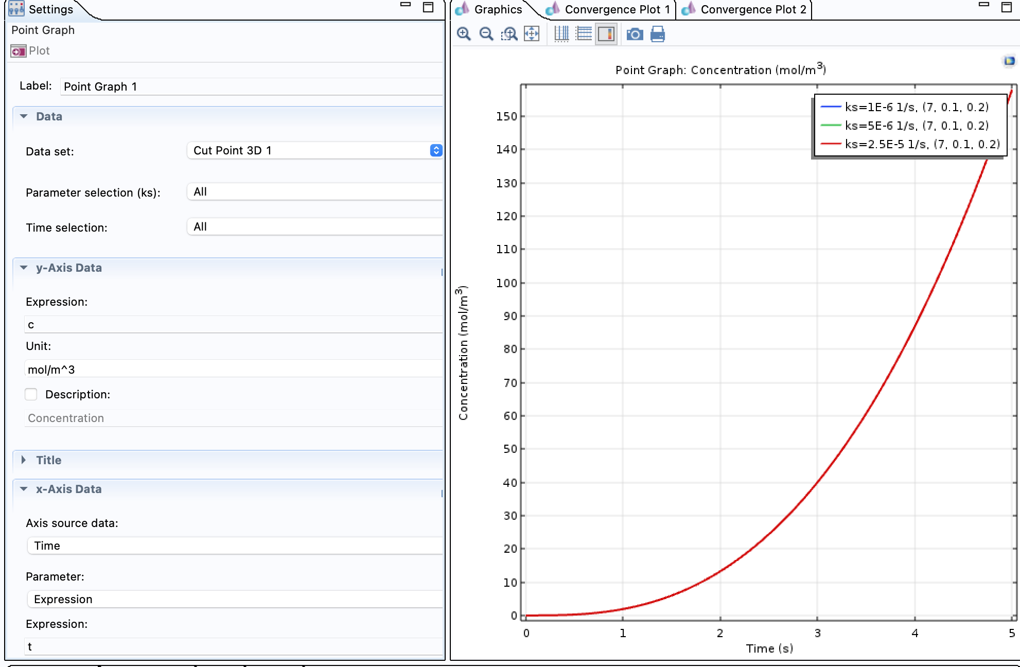

I am working on an implantable drug delivery system. I used release rate ks=1e-6, 5e-6 and 25e-6 in parametric sweep, but all the time I get only one plot even though I select all from parametric sweep. I am using the COMSOL 5.3a version. Can you please guide me about this issue?
I am attaching the picture for your reference.

there are probably 3 identical curves and the red one is on top. So all parameter values gave identical results.
