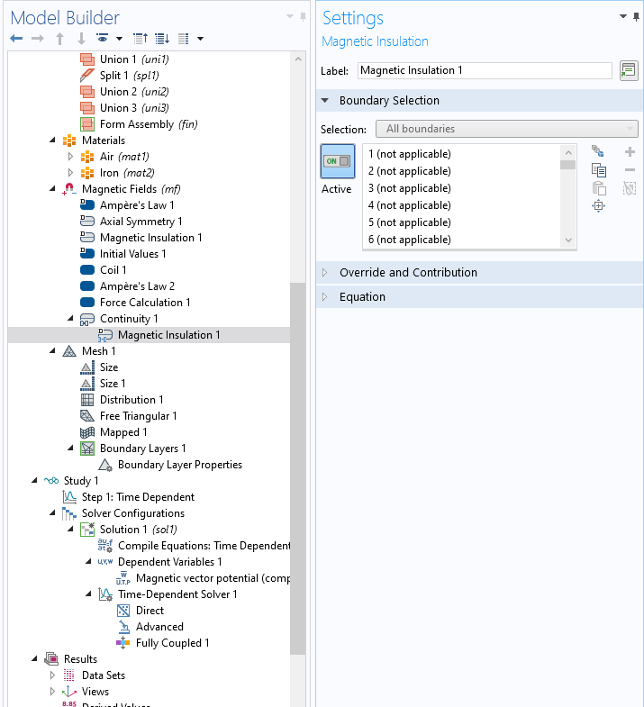

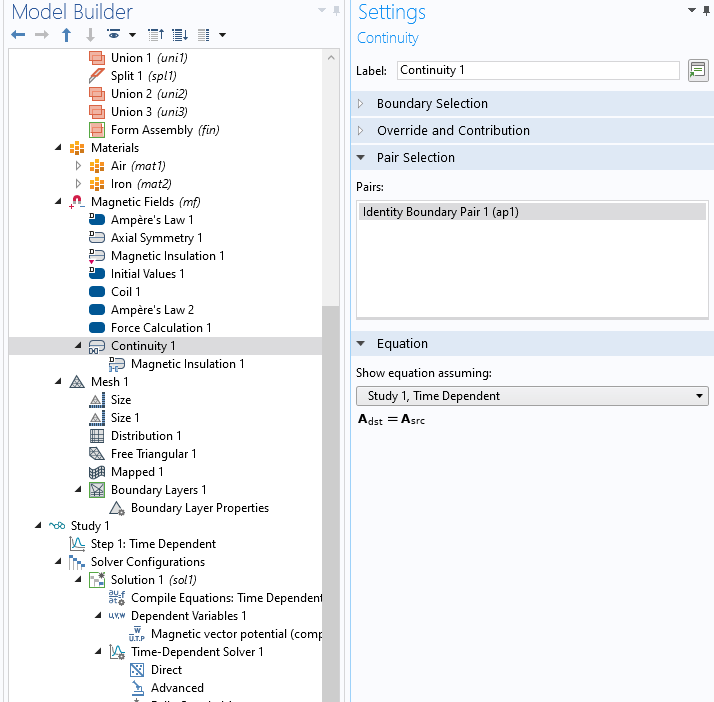

In the video (around 30m:09s), the COMSOL representative adds a continuity in the magnetic field section. Then, he opens up the constraint settings, and manually enables 'Use Weak Constraints'.
Unfortunately, I do not even have a constraint settings tab on my version of COMSOL. I have attached screenshots of my COMSOL model - the options for constraint settings do not appear in the 'continuity' branch of my model, nor it's sub-branch 'magnetic insulation 1'. There should be constraint settings in both of these branches.
Does anyone know the cause of this? Is this perhaps a feature of an older version of COMSOl, that has now been removed? If not, do you know what else it could be?

Hello JoP,
Click on the "Show more options..." button (located at the top of the Model Builder window), then check the "Equation Based Contributions" checkbox. This will enable weak constraints.
PS: I don't have 5.4 on my machine any more, so please confirm in this thread that it solved your problem.
Hello JoP, Click on the "Show more options..." button (located at the top of the Model Builder window), then check the "Equation Based Contributions" checkbox. This will enable weak constraints. Best regards, Jeff PS: I don't have 5.4 on my machine any more, so please confirm in this thread that it solved your problem.

Hi Jeff,
Brilliant - thank you!
Yeah it was under 'Show more options' > 'Show Advanced Physics Options'.
Thanks for your help!
Hi Jeff, Brilliant - thank you! Yeah it was under 'Show more options' > 'Show Advanced Physics Options'. Thanks for your help!
