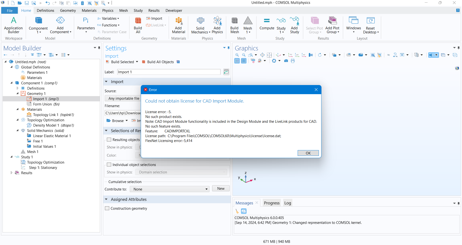

Hey, I tried to import a cad file in comsol it shows the following error. Kindly help me fix it.
"Could not obtain license for CAD Import Module. License error: -5. No such product exists. Note: CAD Import Module functionality is included in the Design Module and the LiveLink products for CAD. No such feature exists. Feature: CADIMPORTCKL License path: C:\Program Files\COMSOL\COMSOL60\Multiphysics\license\license.dat; FlexNet Licensing error:-5,414"
Excuse me for asking, but...do you havea license for either the CAD Import Module or the Design Module?If not, then I think that may be your problem.
Manan,
The COMSOL software is licensed in the modular fashion. To see which products are included on the license you are using, go to File > Licensed and Used Products.
-------------------Jeff Hiller
Hey, did you get the solution to your problem? I even checked the 'Licensed and Used Products' tab and I see 'CAD import module' is selected already. It was always working fine, don't know what happened now.
