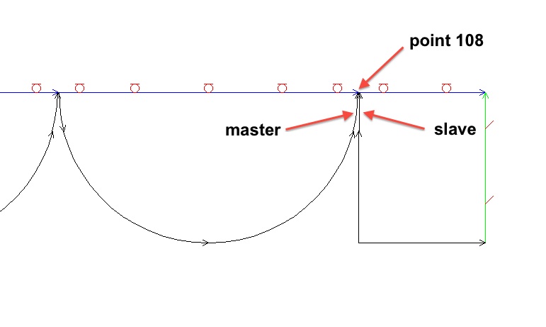

I plotted the gap distance variable (gap_cp21_smps, in my case) for contact pair 21 at point 108, which happens to be on the slave boundary for that pair. I attached a picture of the setup for clarity. The plot which COMSOL generated seems reasonable, however I am unsure of what the data physically represents. I thought that the gap distance variable was simply a distance that I could plot as a function of time. What does it mean to say "the gap distance variable at point 108"?
Also, how would I plot the average value of the gap distance variable?
Ryan
I plotted the gap distance variable (gap_cp21_smps, in my case) for contact pair 21 at point 108, which happens to be on the slave boundary for that pair. I attached a picture of the setup for clarity. The plot which COMSOL generated seems reasonable, however I am unsure of what the data physically represents. I thought that the gap distance variable was simply a distance that I could plot as a function of time. What does it mean to say "the gap distance variable at point 108"? Also, how would I plot the average value of the gap distance variable? Ryan
Posted: 1 decade ago 2013年2月22日 GMT+1 19:20
if you check the doc, the gap distance of a "point" is the distance from that point along the surface normal to the interception of the other boundary, so if you want an average you need to average over a boundary area/distance, not that easy as you might not know where the contact is really over the contact region
