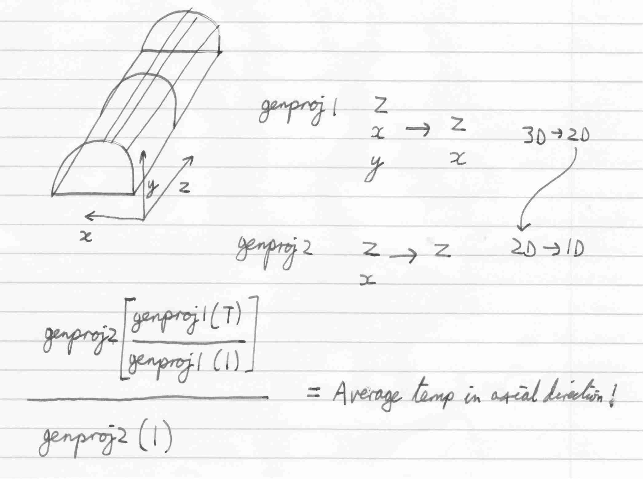

I've attached the model with the bulk average fluid temperature calculated with your suggestions implemented. I used two general projections:
1[K]*genproj2(genproj1(T[1/K])/genproj1(1))/genproj2(1)
So, I have genproj1() z,x,y to z,x, which is integration through the volume projected onto the 2D plane z,x,
And then genproj2() that gives an integration on the flat boundary x,y=0,z from z,x to z,
I drew myself a picture of how it works, I would not have worked that out from the manual! (I attached it as a .zip as well because I found I could not re-open the first file.)
Thank you very much for your help,
Adam
