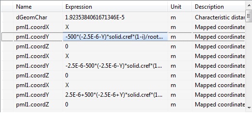

PML Coordinate Stretching
When I see the equation mode, PML in one of the direction (mapped coordinate e.g. y direction) is stretched to complex number but another remains only real for my 2D analysis, why is that?
Also does PML work for eigenfrequency analysis?
Any help would be appreciated. Thanks.

I guess that's because in that domain only waves propagating in the Y direction need to be absorbed.
