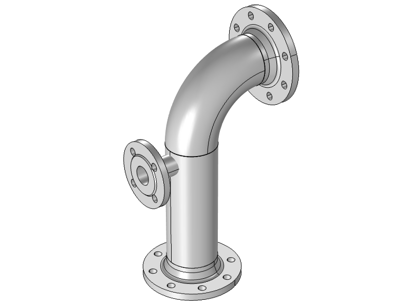

The situation is that two water streams of different magintude and temperaure are to be mixed. The result of the analyze should be an average temperature and also a visual indication of how well the two flows are mixed.
I have attaced a picture of the setup. I would like to simulate the flow on the inside of the pipes. The flow enters the from the bottom and the side nozzles and exits from the top.

Hi Simon,
You can create the interior volume of the pipe using the "Cap Facces" feature in the geometry branch. Right-Click "Geometry" and select "Cap Faces". Select the edges that enclose the openings of the pipe.
www.comsol.com/blogs/meshing-cap-off-for-cap-on/
Morten
