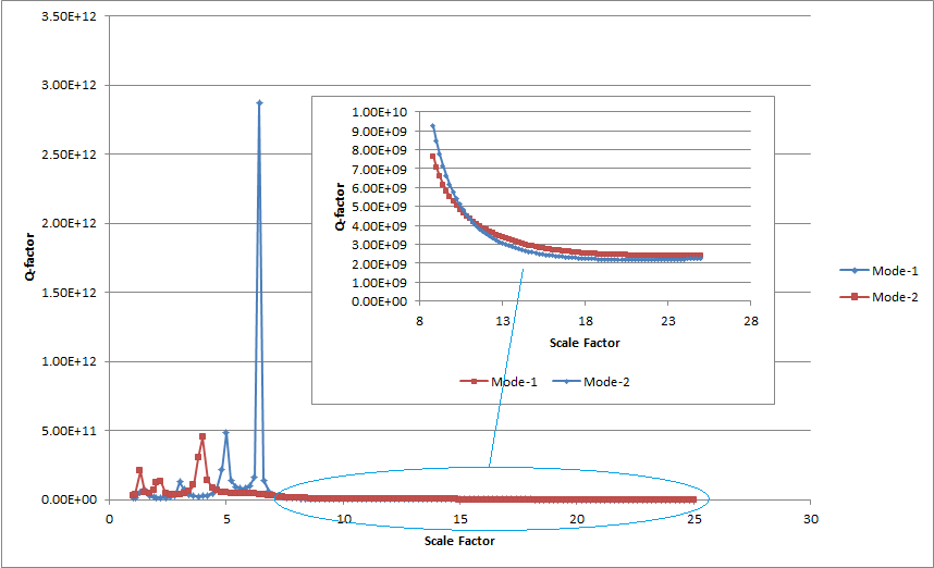

I have attached a file showing a convergence curve. I have used rational stretching and varied the scale factor gradually. You can see that as SF increases the Q-factor tends to converge. My PML was of reasonable width compared to the geometry. Please have a look at it.Thanks.
Posted: 1 decade ago 2014年3月31日 GMT+2 20:35
Ruzbeh,
I see a reasonable convergence trend. So what is your main question?
cheers,
Felipe BM
Ruzbeh, I see a reasonable convergence trend. So what is your main question? cheers, Felipe BM

Posted: 1 decade ago 2014年4月8日 GMT+2 18:08
Dear Felipe
Thanks for you reply. I have attached a graph of my Q-factor vs scale factor. Generally the two modes are expected to have similar Q values. But there's a difference between two Q values initially. As SF is increased further two values become similar BUT you could see the divergence of the two curves. I hope you could give some suggestion on that.
Also, how accurate are cylindrical/spherical pmls compared to rectangular ones?
Dear Felipe Thanks for you reply. I have attached a graph of my Q-factor vs scale factor. Generally the two modes are expected to have similar Q values. But there's a difference between two Q values initially. As SF is increased further two values become similar BUT you could see the divergence of the two curves. I hope you could give some suggestion on that. Also, how accurate are cylindrical/spherical pmls compared to rectangular ones?
Posted: 1 decade ago 2014年4月8日 GMT+2 21:08
Ruzbeh,
What you show in your graph is, I suppose, the expected behavior for a PML:
If you put a low scaling factor, it is similar to put a low-absorption boundary condition. Then the outgoing waves will go in and out of your PML causing spurious reflections.
If you put a high scaling factor, it is similar to put a very-absorptive boundary condition (high conductivity) and it will behave as a metal, which will translate also in spurious reflections.
PML success, as in live, depends on having the exact amount of each ingredient... that is why PMLs are perfect :)
There are lots of papers about how to tune the PML parameters. I dont know any of them applied to the area of MEMs or Structural Mechanics, but I'm sure a simple search will lead you in that way.
If I were you, wouldn't waste more time and start using a scaling factor between 35 and 40.
good luck with your experiment,
Felipe BM
