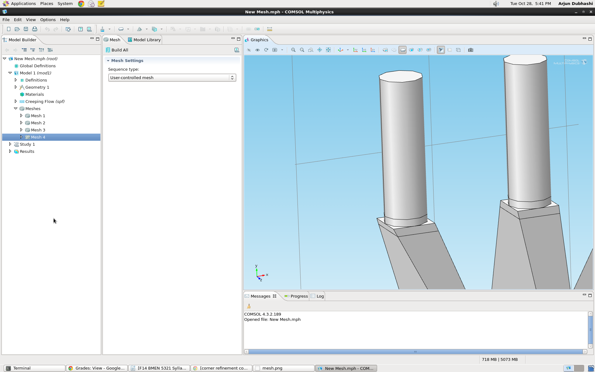

Meshing without high mesh density and with high minimum mesh quality
I'm trying to mesh the interface between what is essentially a cylinder and its base. The model is imported and I would prefer not creating a chamfer or fillet unless I can edit an imported model without much hassle.
I tired using smaller elements but the resultant minimum mesh quality remains poor. To the order of e-5.
I would really appreciate any inputs. Kindly find a model attached with this post.
Cheers!!

Hello Arjun Dubhashi
Posted: 10 years ago 2015年12月4日 GMT+1 16:13
The Design Module allows you to add a 3D fillet, including to an imported geometry. See www.comsol.com/design-module .
The Design Module allows you to add a 3D fillet, including to an imported geometry. See www.comsol.com/design-module . Best, Jeff
