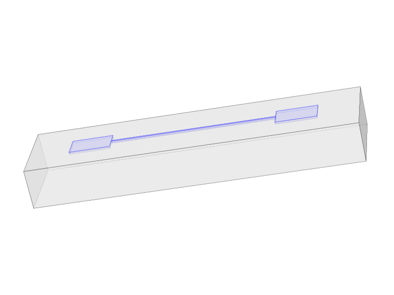

I am a relative beginner to COMSOL and I am trying to build and mesh a solid block with a shallow indent at the top. I have tried so many configurations (splitting into two layers, sweeping from different sides, etc) but each returns a different error. The problems seems to be the vertical walls of the indent.
Is there any clever way of doing it? I would be very grateful for any suggestions.

Sure. I've tried to do it while submitting but the script seemed to be temporarily not working.
In the end I would like to have a metal thin structure (blue) embedded in a larger substrate (grey).

Posted: 1 decade ago 2014年10月31日 GMT+1 13:04
Measures of the geometry?
Posted: 1 decade ago 2014年10月31日 GMT+1 13:22
Total dimensions (width x depth x height) 2mm x 8mm x 1mm
dimensions of the thin embedded structure: 40um x 4mm x 50nm
Total dimensions (width x depth x height) 2mm x 8mm x 1mm dimensions of the thin embedded structure: 40um x 4mm x 50nm
Posted: 1 decade ago 2014年10月31日 GMT+1 14:35
Did I understand it correct at all?
Attached my geometry with a mesh.
Did I understand it correct at all? Attached my geometry with a mesh.
Posted: 1 decade ago 2014年11月10日 GMT+1 09:58
Yes! Thank you!
