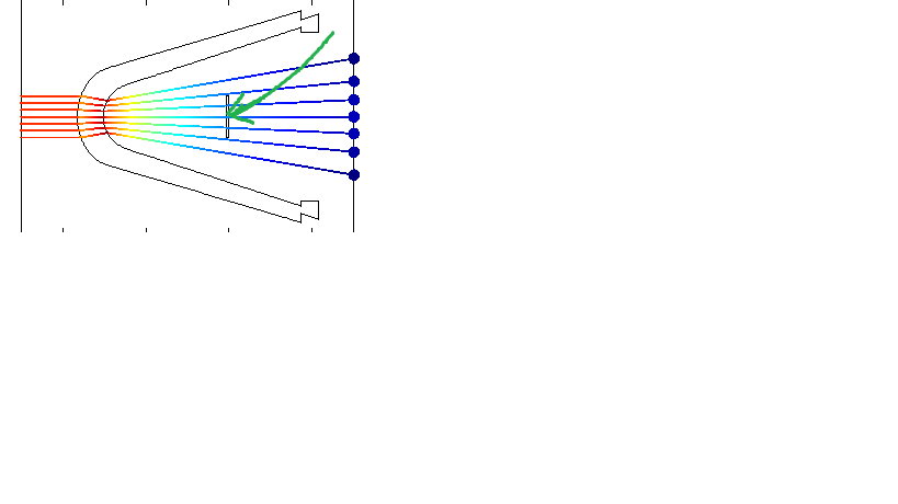

The exact question is that ,how can i compute the sum of ray intensity reached a specific line .geometry image is attached . The green arrow indicates the line(The sum intensity should be computed in line)

Dear Daniel , thanks for your response . I actually set the "Intensity computation" property ,that can compute ray intensity and polarization . The exact question is that ,how can i compute the sum of ray intensity reached a specific line .geometry image is attached . The green arrow indicates the line(The sum intensity should be computed in line) Kind Regards,

Hi, the intensity only exists on the rays themselves, not on boundaries or domains. May I ask what you are trying to compute? If you are interested in the power transfer from rays to a surface, you can use the "Deposited Ray Power" boundary feature. AN example of how to use this can be found i the model Model Libraries>Ray Optics Module>Industrial Models>solar_dish_receiver.

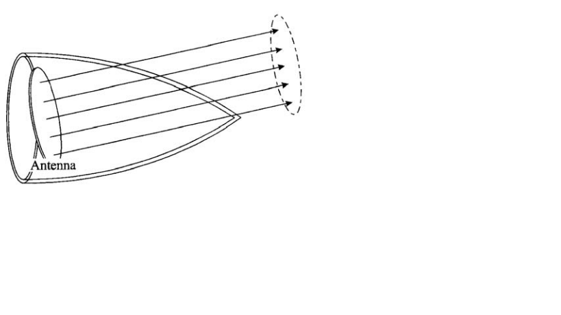

I actually want to calculate far-field radiation pattern of an antenna that is extremely large .
as dimension of antenna is much more than lambda , simulation cant be run in RF module. I have to use geometrical optic .
i am interested in power(intensity)distribution on an equivalent aperture as showed in attached image .
is it possible to change equation of geometrical optic module such that ignore refraction of rays on Material Discontinuity?
as showed in attached image, rays don't refracts as arrive new environment
Dear daniel , Please accept my apology for the slow response, I should have responded sooner. I actually want to calculate far-field radiation pattern of an antenna that is extremely large . as dimension of antenna is much more than lambda , simulation cant be run in RF module. I have to use geometrical optic . i am interested in power(intensity)distribution on an equivalent aperture as showed in attached image . is it possible to change equation of geometrical optic module such that ignore refraction of rays on Material Discontinuity? as showed in attached image, rays don't refracts as arrive new environment
