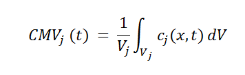

I am working with a 2D axisymmetric geometry of the arterial wall. I am solving transport of diluted species (time dependent). I would like to compute the volume averaged concentration of the eluted drug in each of the layers of the arterial wall, at any instant. How can I do this?
I attach the equation.

Use the volume integration and divide it by the volume which you get by integrating the "variable" 1 over the domain.
