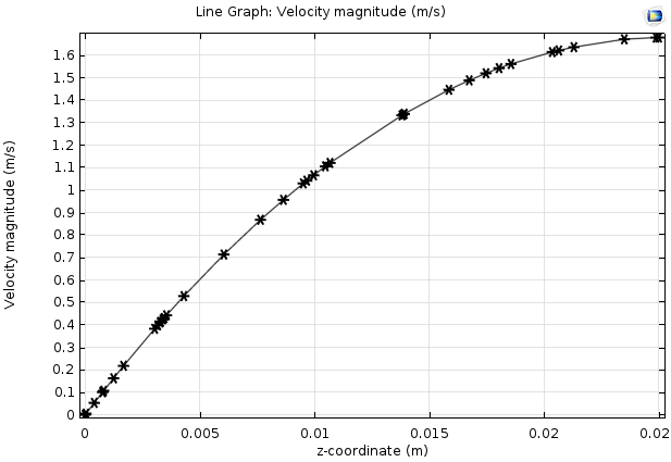

Why data points are nonuniform in 1D Plot?
I have plot velocity profile(see attached figure) on inclined plane using 1D plot group but the data points is not uniform. Can anyone please tell me how to set uniform data points in 1D Plot

This would be fairly typical of a situation where your mesh is not uniform along the line where you are plotting. Could this be what's happening here?
This would be fairly typical of a situation where your mesh is not uniform along the line where you are plotting. Could this be what's happening here? Jeff
